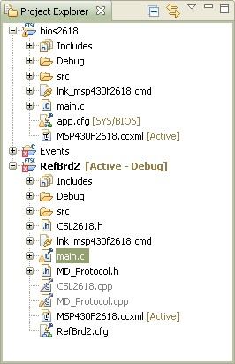

My sys/bios .cfg file is no longer tagged [SYS/BIOS] in one of my projects.  That is, in the Project Explorer window, the cfg filename is NOT followed by "[SYS/BIOS]".
Does anyone know  what I did?  And more importantly, how do I correct this problem?

  • Hi AatiG,
      No, not the classification, which is correct, rather a [bracketed] attribute:
    Note for the 'bios2618' project, the file app.cfg shows the [SYS/BIOS] attribute but the configuration file for the RefBrd2 project, RefBrd2.cfg does not have the [SYS/BIOS] attribute. This is a problem because the XGCONF editor only shows a blank screen.

  • Fred,
    It seems like the [SYS/BIOS] attribute appears after the .cfg file has been opened once. When I create a new SYSBIOS project, the .cfg is first shown without the attribute. Once I double-click on the file to open it in the editor, then the attribute appears.
    Are you saying that the RefBrd2.cfg opens up to a blank screen? If so, could you check the RTSC tab under project properties and post a screenshot of the versions of XDC and SYSBIOS the project is set to use? Is this the only project where you cannot view the configuration file properly or are there others as well? Was it a CCSv4 project imported into CCSv5 or one that was created new with CCSv5?

  • HiAartiG,
    Yes, with the XGCONF editor.
     > Is this the only project where you cannot view the configuration file properly?
    Yes.  When I created the project the XGCONF editor  worked as expected.  I slipped on the keyboard (pressed some "random" keys) and all of a sudden XGCONF displayed a blank screen. The file can be displayed with the regular text editor, and has no obvious (to me ;-) defects. The editor still works on other projects.  Here is the screen shot you asked for:

  • In desperation I deleted the configuration file and copied the msp430 "idle" configuration file from:
    C:\ti\bios_6_32_05_54\packages\ti\sysbios\examples\msp430\idle
    to my project directory.  I then doubled clicked on "idle.cfg" and I'm back in business.
