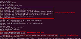

  • Thank you very much for your reply! I have modified the part you mentioned, but still get the error `VX_ZONE_ERROR:[vxReplicateNode:2020] Invalid reference type` .
    According to the log of the error screenshot below , We can see that I have successfully executed the `tivxAddKernelPixelViz` part in `tivx_pixel_visualization_host.c` , and the error is reported at the `vxReplicateNode`  of `app_post_proc_moudle.c -> app_create_graph_post_proc` .

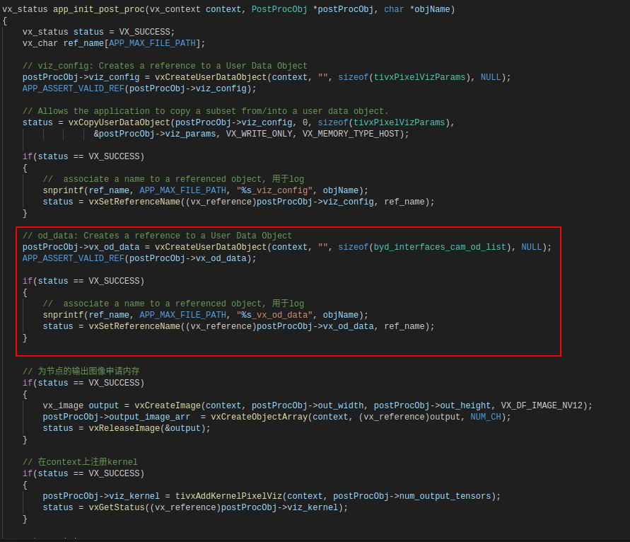

    The following are screenshots of the parts I modified. Please check if there are any omissions or errors.Thank you very much for your review!
    I understand what you mean, but my data is stored in a custom structure `byd_interfaces_cam_od_list`(As shown in the figure below), and I don't know how to put it into vx_object_array.
    I searched the document and tried the following methods(As shown in the figure below), but still got an error `VX_ZONE_ERROR:[vxReplicateNode:2020] Invalid reference type`.
    Is there a simple example of putting data from a custom structure into vx_object_array or vx_array?
  • Hi Wang,
    You can see the postProcObj->output_image_arr creation part as a reference,
    instead of crteating postProcObj->vx_od_data create postProcObj->vx_od_data_arr of type vx_object_array
    and then follow the snippet,
    vx_user_data_object od_data = vxCreateUserDataObject( context, "some_name", sizeof(byd_itnerfaces_cam_od_list), NULL);
    postProcObj->vx_od_data_arr = vxCreateObjectArray(context, (vx_reference)od_data, NUM_CH);
    status = vxReleaseUserDataObject(&od_data);
