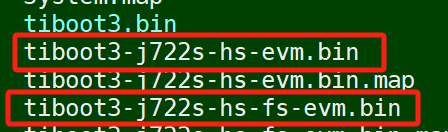

1.  the default keywriter TI dummy key:${PSDKRA_PATH}/pdk/packages/ti/build/makerules/k3_dev_mpk.pem
2.  but  uboot signature different key
3. The difference between the two:
tiboot3-j722s-hs-evm.bin tiboot3-j722s-hs-fs-evm.bin
4. I generated a new key by myself (smpk.pem), how do I replace the key in the Uboot.
    Both keys are same. You can run cat command on ke_dev_mpk.pem and custMpk.pem
    • tiboot3-j722s-hs-evm.bin -> tiboot3.bin binary for HS-SE device.
    • tiboot3-j722s-hs-fs-evm.bin -> tiboot3.bin binary for HS-FS device
    Have you flashed the corresponding public key onto the device ? If yes, you can just replace it with the custMpk.pem
