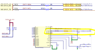

We refer to TDA4VE EVM (including the SOM, CPB and Fusion Board) as the basis for our custom board design.
The UB960 serializer is connected to I2C5 of the main domain, consistent with the EVM configuration.
However, we found that I2C5 is currently inaccessible for both read and write operations on our custom board.

We have no idea why the same software configuration fails on the custom board.
Your guidance would be greatly appreciated, and I look forward to your reply.

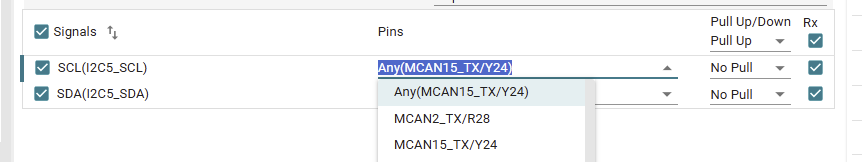

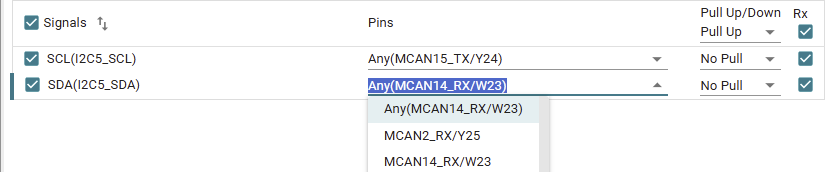

    1. Can you double check if the same pins are used for the I2C5 on your custom board?
      1. There are 2 sets of pins so just double confirm the pins.
    2. Can you also cross check on your custom board in Linux by reading back the pin mux registers?
      1. /* This file was auto-generated by TI PinMux on 5/26/2025 at 10:11:27 AM. */
        /* This file should only be used as a reference. Some pins/peripherals, */
        /* depending on your use case, may need additional configuration. */
        &main_pmx0 {
        myi2c1_pins_default: myi2c1-default-pins {
        pinctrl-single,pins = <
        J721S2_IOPAD(0x01c, PIN_INPUT, 8) /* (Y24) MCAN15_TX.I2C5_SCL */
        J721S2_IOPAD(0x018, PIN_INPUT, 8) /* (W23) MCAN14_RX.I2C5_SDA */
    3. In your custom board boot to Linux & try:
      'dmesg | grep i2c' Just double check if indeed main_i2c5 is probed successfully.
    - Keerthy

    [    0.828290] omap_i2c 40b10000.i2c: bus 2 rev0.12 at 100 kHz
    [    0.934569] omap_i2c 2000000.i2c: bus 3 rev0.12 at 400 kHz
    [    1.959428] omap_i2c 2050000.i2c: timeout waiting for bus ready
    [    1.976186] omap_i2c 2050000.i2c: bus 4 rev0.12 at 400 kHz
    We are wondering: since the same bootable SD card works correctly on the TDA4VE EVM and the main_i2c5 interface is readable.
    Does this imply that main_i2c5 has been configured properly?
    We also double checked Y24 and W23 is only connected to UB960
    Thank you very much.
    Christopher
  • Hello Christopher,
    I see the pin mux is set correctly. I will loop in our hardware experts. Please expect a delayed response as it is a long weekend for the US team.
    - Keerthy

  • I've not seen this type of error before.  How is VDDSHV2 powered?  Have you verified the voltage is correct (3.3V) on these power input pins (M20, R20)?  Note the EVM supported some more advanced IO features (IO Retention), and thus these pins may have been connected to a different power source. Also please confirm the power rails VDD_WAKE0 (pin 20).   This should be connected to VDD_CORE (if not supporting retention modes)
  • Hi Robert,
    Thank you for the helpful information.
    We’ve checked that VDD_WAKE0 (pin 20) is connected to VDD_WK_0V8. However, we noticed that on our custom board, VDD_WK_0V8 is not connected to VDD_WK_0V8_REG, which is the output of PMIC-B LDO1.
    After connecting VDD_WK_0V8_REG and VDD_WK_0V8, the IO pins of VDDSHV2 IO group could be properly controlled.
    Thanks again and the thread could be closed.
