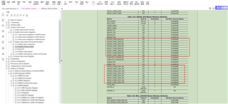

On TDA4VH, are those QOS of R5 configurable? I know VM is configurable, but all these registers on VH read 0.
Note: The reason I do this is because we have a problem on our side: When we turn on the display function, the spi interrupt processing time increases by one half, which causes the spi related functions of R5 core to be abnormal, so we try to modify the QOS to enhance the interrupt processing speed of R5 core. If you have other solutions to this problem or can reduce the spi interrupt processing time, please let us know.
  • Hi Li Quan,
    Yes, these registers are correct and are accessible even on VH device. 0 might just be reset value of these registers.
    Before going into solution, can you please elaborate on the issue? Display alone should not have affected SPI. How frequently are you sending or receiving messages over SPI? Are you using CPU mode or DMA mode in SPI? From which core are you accessing SPI?
    Brijesh
  • HI Brijesh,
    We send and receive data once every 1,2-3 milliseconds when MCU3_1 core accesses spi, and the maximum amount of data at one time is 132 bytes. The hardware processing of spi should be OK. From our test, we found that the main reason is that R5 interrupt processing function takes too long in software, which leads to related function abnormalities. Turning off the display significantly reduces interrupt function processing time.
    Our current suspicion is that R5's register accesses inside the interrupt take more time due to the lack of overall system performance resources, and thus the overall interrupt handling function takes more time.
    So we want to adjust the QOS to improve the access efficiency of R5 and reduce the interrupt handling function time.
