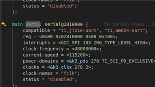

    As for your question - yes , I did made some changes to the device tree files.
    1. k3-j7200-main.dtsi - I did the following changes
    I changed the status from "disabled" to "okay" in both MAIN_UART0 and MAIN_UART1.

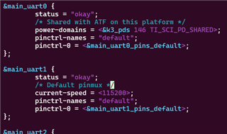

    2. k3-j7200-common-proc-board-dts - I made the following changes.
    I only added baud rate in &main_uart1 and added the following line current-speed = <115200>; because I was trying to work with that uart.
    Sarthak Sharma
  • Hi Sarthak,
    These changes should be fine to get main uart0 and main uart 1 working.

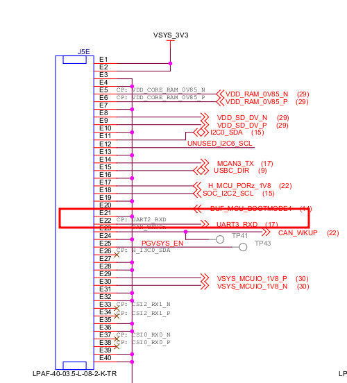

  • Hi Sarthak,
    Is there documentation or a schematic that outlines this mapping, or any recommended way to confirm it (e.g., from the device tree or board files)?
    The remapping is present in the SOM schematics. I am attaching the reference for the same below :
    Please refer to SOM to COMM PROC PRIMARY CONN #2 heading the below file:
    SOM_SCH.pdf
    I am also attaching the snapshots of the remapping below:
    CP indicates the base board
    • Hence, UART 1 and UART3 can be used .
    Gokul
