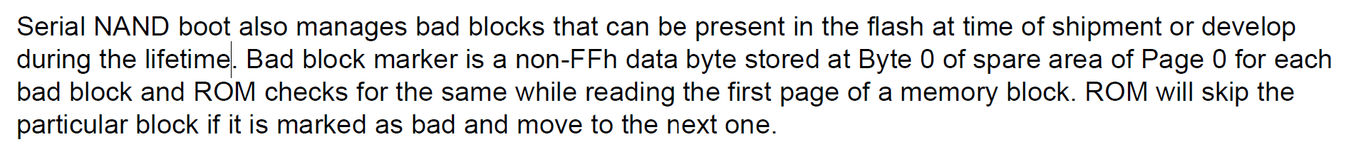

  • Hi Kevin,
    Vaibhav is out of office today. But I can summarize my discussion with the experts on this.
    1. Bad block marker (non 0xFF) value written by the SoC.
    2. The identification of a "new" bad block (which is not tagged yet, but has gone bad) happens when the SoC tries to write/erase to the flash and that operation doesn't complete successfully. At this point, the SoC writes the spare area i.e. 1st byte of the 1st page in the block by a non 0xFF value.
    3. Upon every boot, the SoC creates a local list of bad blocks in an array by reading the spare area. This array gets updated when any new bad block is identified.
    4. Support for tagging bad blocks based on the ECC on the NAND flash is not supported today in the software, the mechanism which I explained in point 2 is what is used today.
    Now coming to the specific scenario when during a firmware update, if the power loss happens, the write to a page in the block may still be in flight. This may or may not cause a bad block. In case when it does create a bad block, upon the next boot whenever you try to re-write to the same block, below will happen.
    1. SoC boots and creates an array of known bad blocks by reading the spare area. The block which turned bad during the last failed firmware update is still not tagged.
    2. During the new write cycle, SoC tries to write to the same block which had turned bad due to a power loss during an in flight write in the last firmware update cycle.
    3. Write fails on this block, SoC writes the spare area for that block by a non 0xFF block (marking it bad) and updates its local array for bad blocks.
    4. SoC jumps to the next good block and writes the same data. This is the bad block management logic where you try to write the data to the next good block.

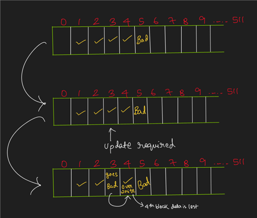

  • Hi Karan,
    Thanks for providing this details, I have discussed with customer that in the most of cases padding few blocks will work, but there could be a special situation that this may still have some concern.
    In most cases
    Customer re-flash the entire SW image, for example, the SW image will be written to block 1-10, and block 5 is bad block, then according to our bad block management logic, we will actually write block 1-4, & 6-11. Then if customer pad block 11 in their design this will not have any problem.
    In special case
    There is a SW component or some important data that have already been saved in block 1-4, during the runtime, customer may only update a part of the important data, let's say re-writing to block 3, then if bad block happens, according to our bad block logic, the block 4 will be overwritten, and this seems padding few blocks method will not work in this situation.
    Customer discussed with me that to resolve the above special case, could we modify our bad block management logic a little bit that every time we try to write to a new good block we check if that is empty or not and until we find the empty block.6
    However, i think if we modify our logic like this, it will affect the above "in most cases" result, as we will write to block 11 for the data which originally will write to block 5, and results that the block 6 data will write to block 12.
    May I know how do you think about this?

  • Hi Kevin,
    The current SDK flow is as following:
    Notice, how the 4th block is overwritten with the updates made to block 3. Since block 3 went bad we write to the block 4 as block 4 is good.
    Currently in the SDK we do not check if the block we are writing to is already having some binaries flashed. This is expected by the customer to take care of.
    So the implementation from the customer's end should be to just add a check if the next block is good and there is no binary flashed already, hence we write to it.
    Vaibhav
  • Hi Vaibhav,
    Thanks for the reply.
    Based on the above case, if customer adds a check if the next block is good and there is no binary flashed already. Then, the 4th block which goes bad will be written to block 6. And then, we we write a next data, will it be written to block 7 or 4?
    Based on this theory, if customer wants to reflash an image which covers block from 0 to 99, customer has to erase the original image before flashing the new image right? If customer did not do it, then once a bad block happens in the middle, and if customer implements a check if the next block is good and there is no binary flashed already, then the original image will not be fully written by the new image.
    Kevin
  • Hi Kevin,
    I think you meant when the 3rd block goes bad and we want to update the binary in the 3rd block, then in this case, since:
    4th is good but has binary so we skip
    5th is bad so we skip
    6th is good and has no binary, hence the update is made here.
    This is a correct understanding, before writing to any block, erase should be performed on that block, this will follow up a write operation.
