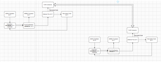

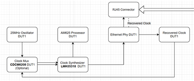

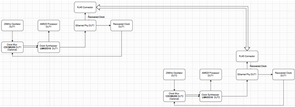

I want to connect Ethernet Phy (DP83869HM / LAN8841) to the AM625 Processor which support Synchronized Ethernet (Sync-E) to allow synchronization across mutiple DUTs.
I have connected the Processor with Sync-E ethernet Phy as follows and wanted to confirm with you before I go further in my design.
| Ethernet PHY (e.g., |
| DP83869HM / LAN8841)|
| - MAC Interface: |
| RGMII/SGMII |
| - SyncE Clock Out |
| (CLK_OUT or |
| REF_CLK_OUT) |
| Recovered Clock (125 MHz)
| Optional Clock Buffer | <–– e.g., TI CDCM61001 or LMK1C1104
| (cleaning/fan-out) |
| Processor (e.g. AM625) |
| OSD6254-1G-IPM SoM |
| EXT_REFCLK1 (Pin D16) ◄––––– Recovered Clock Input
| Used by: |
| - CPSW3G MAC |
| - PLL for TSN/PTP |
Is the architecture I am following for my application is the correct one ? Please guide me.
