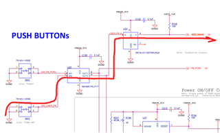

I'm working on the AM68A SK board and trying to read the state of the user button SW3, which I believe is mapped to GPIO line 69 on gpiochip3.
I ran the following command:
gpioget -c /dev/gpiochip3 69
The output is always:
"69"=inactive
This result does not change regardless of whether the button is pressed or not.
Questions:
  1. Could you confirm if GPIO3_69 is the correct mapping for SW3 (user button)?
  2. Is there any configuration needed (e.g. muxing, pinctrl, direction, bias) in Linux or device tree to enable reading the button?
  3. Can you provide a method or reference to test SW3 functionality under Linux?

  • Hi Noushad,
    I looked into this a bit more deeply, did some experiments using a board I borrowed from a colleague, and it seems there are a couple of typos in our schematics and datasheet.
    Instead of WKUP_GPIO0_69, WKUP_GPIO0_33 is connected to the user pushbutton "SW3" for SK-AM68A. And it looks like no additional pinmuxing is needed in device tree. Please refer to below logs:

  • Hi Noushad,
    I understand the user guide and schematics say SW2 is mapped to WKUP_GPIO33 instead of SW3. However, I reviewed the schematics and I found SW3 labeled as USER PB looks to be connected to SOC_WAKE, which is WKUP_GPIO33 instead of 69.
    I think the user guide has these switched, because I was able to use SW3 for WKUP_GPIO33 as shown in logs. Additionally, as an experiment, I toggled WKUP_GPIO69 through gpioset and this caused a reset to happen, which makes me believe WKUP_GPIO69 is connected to SW2 labeled as PORZ (Power On Reset).
    As an experiment, before reading/writing to the GPIO pin values, you could try to read and write to the PADCONFIG registers that the dts file should be setting using devmem2. Specific commands are:
    • To read PADCONFIG of WKUP_GPIO0_33: "devmem2 0x4301C048"
    • To set RXACTIVE bits and pinmux as 7 (GPIO): "devmem2 0x4301C048 w 0x50007"
    • To read PADCONFIG of WKUP_GPIO0_69: "devmem2 0x4301C0A8"
    • To set RXACTIVE bits and pinmux as 7 (GPIO): "devmem2 0x4301C0A8 w 0x50007"
    This should let you read/write the value of the GPIO pins using gpioget/gpioset.
