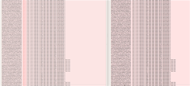

Hello zhenzhou
I compared layer traces on pc an evm on sdk 11.0. I don't see mismatch:
Can you try this as well on your side?
