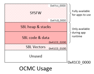

My baremetal application, running on mcu1_0(Cortex - R5F0) wants to access the locations in OCMC_RAM Region - 0x41C00000 - 0x41C80000.
In the below table, from 8.3. MCU1_0 Application Development with SYSFW — Processor SDK RTOS J721E, I can see that the Memory region (512KB) can be reclaimed by the application after SBL execution.
But when I run my app, the app hangs when it is trying to access the 0x41C0000 address.
What areas of the OCMC (41C00000 - 41D00000) ~1MB should be left untouched and what can be used?
Thank you!

  • Hi Karthik.
    Can you please elaborate this,
    The SBL loads the MCU1_0_sciserver_app. During the load process the aforementioned memory should not be loaded/altered
    this is only for the region 0x41C00000 - 0x41C80000 (first 512KB). But the other region, 0x41C80000-0x41CC0000 (256KB) can be used for my application, as shown in the figure below?
    Please confirm.
    Thank you!
    BR
  • Hi Arun,
    You can use the memory region 0x41C80000-0x41CC0000 (256KB)  for your application.
