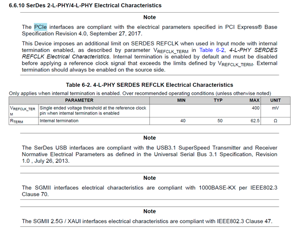

On device datasheet pin attributes table the SERDES lines are referred to have 4L_PHY voltage buffer type.
Table 6-2 defined the 4-L-Phy SERDES REFCLK electrical characteristics, but what would be the electrical characteristics for the RX_ and TX_ data lines?
