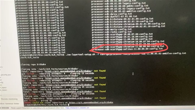

customer want to build Yocto file system, but they don't know which file should be used in SDK11.0, pls help.

go to the SDK-specific Yocto build steps here: https://software-dl.ti.com/processor-sdk-linux/esd/AM62X/11_00_09_04/exports/docs/linux/Overview_Building_the_SDK.html#build-steps
And then on that page there's a (somewhat hidden) hyperlink saying "refer to here" you can click on to get to the required config file to be used. In case of AM62x SDK v11.0 this link will lead to: https://software-dl.ti.com/processor-sdk-linux/esd/AM62X/11_00_09_04/exports/docs/devices/AM62X/linux/Release_Specific_Yocto_layer_Configuration.html#yocto-layer-configuration
Regards, Andreas
The difference between both of the configuration variants is listed here :
