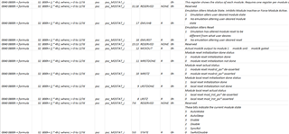

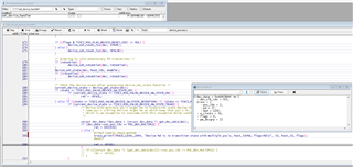

When we cyclically stop and start the main domain firmware using remoteproc, the shutdown process occasionally fails.
We were able to trace the issue back to the SciServer (Enabled the sciserver tracer)
Failed main domain r5f shutdown looks
CPSW1 set_device_handler: id=62, host_id=37, flags=1538
0x6040003E: Power Management:   DEVICE_OFF(Device has been Turned OFF): Device ID: 62
0x63EEE001: Power Management:                   MODULE_PUT(Module Put): PSC ID: 2 LPSC ID: 119 Module Use Count: 1
0x60C002F2: Power Management: CLOCK_DISABLE(Clock has been Turned OFF): Clock ID: 754
0x60C000F2: Power Management: CLOCK_DISABLE(Clock has been Turned OFF): Clock ID: 242
0x646EE001: Power Management:             RETENTION_PUT(Retention Put): PSC ID: 2 LPSC ID: 119 Module Retention Count: 1
0x6324A002: Power Management:                 PD_PUT(Power Domain Put): PSC ID: 2 Power domain ID: 37 PD Usage Count: 2
0x6324A001: Power Management:                 PD_PUT(Power Domain Put): PSC ID: 2 Power domain ID: 37 PD Usage Count: 1
set_device_handler failed with error: id=62, host_id=37, flags=1538 ret=-427

    I was able to narrow down the problem per jtag debugger. It looks something get wrong with PD (PowerDomain) 37
    Configuring trace data version to: 0x03007
    Device 62 is in transition state with multiple psc's, host_id=37, flags=1538

    What I have noticed about is, if everything is working the corresponding new LPSC looks this
    LPSC module: dev=a049d711, module idx=94, state=0x03
    However, when it fails, I see this instead. It differs in state (ok) but in module idx? Could it be that there are some race conditions of
    multiple parallel requests?
    LPSC module in transition: dev=a049d711, module idx=119, state=0x0a
    Kind Regards

    I believe there's a misunderstanding between bit positions and actual values. The  "MDSTAT_STATE_*" macros represent specific bit patterns corresponding to various states. However, the code compares the entire state variable directly to these macros, rather than isolating and comparing only bits 0 through 5. This could result in incorrect comparisons.
    PowerDomain MDSTAT Status Values are:
    Bit5 | Bit4 | Bit3 | Bit2 | Bit1 | Bit0
    Auto | Auto | En   | Dis  | Sync | SwRst
    Wake | Sleep| able | able | Rst  | Disbl
    MDSTAT Register definition from J784S4_Registers_20240628.xlsx
    The available constants at the pdk psc.c file are:
    #define MDSTAT_STATE_SWRSTDISABLE       0x00U
    #define MDSTAT_STATE_SYNCRST            0x01U
    #define MDSTAT_STATE_DISABLE            0x02U
    #define MDSTAT_STATE_ENABLE             0x03U
    #define MDSTAT_STATE_AUTO_SLEEP         0x04U
    #define MDSTAT_STATE_AUTO_WAKE          0x05U
    I believe the above are not bitfields, direct values of PSC_MDSTAT.status.
    If the above are bit fields and SW assumes direct values, all requests to enable/disable the Module would have failed.

    I tried to reproduce the power domain issue and using a Lauterbach JTAG debugger to monitor it.
    I set a conditional breakpoint that triggers when the lpsc status register is read with the value 0xA by the CPU (mcu_1_0).
    According to the code in the Sciserver, the status register can take the following values (see definitions below). However, the value 0xA is neither defined in the code nor documented
    Do you have any idea what this value might represent, or under what conditions it could occur?
