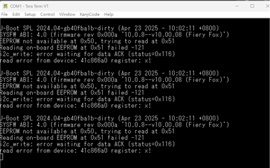

Champ,
Customer board just came back and booting but it stuck in EEPROM check as below console log.
This EEPROM is not existed and how to skip the access and assign corresponding board ID in loader to keep booting.

Keerthy,
Currently, SDK10.1 is used, customer hasn't tried SDK 11.1 yet.
We had found a old e2e as below and make sure it is working. We can close this.
Re-build the u-boot without this compile option: TI_I2C_BOARD_DETECT
