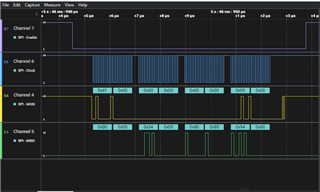

I am running an test application for SPI Driver Version 9.0.1 on the R5 core of AM62A-LP SOC attached code and configuration
  • Configuration:
  • Test Code:
  • Output on the SPI Bus:
  • dbg_rxbuffer values in the debugger: {0x00,0x00,0x34,0x00,0x80,0x80,0x94,0x00} Match the Data on the SPI BUS

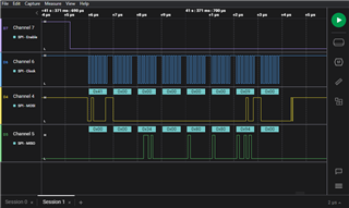

The Issue is when I am changing the Data width to be 16 instead of 8 the value of the dbg_rxbuffer doesn't match the actual data on the SPI BUS.
Kindly check the modification for this part:
  • Configuration:
  • Test Code:
  • Output on the SPI BUS:
  • dbg_rxbuffer values in the debugger: {0x0000, 0x3400, 0x3400, 0x3400} but this doesn't match what we could see on the SPI BUS.

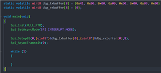

    As I was reviewing the code, I see that in the second case, you have declared uint8 buffer and for the API call Spi_SetupEB you type cast it as uint8 itself.
    But for the uint16 case I se you type casting it as uint8, that should cause issues right? Could you please check it and configure it accordingly and check.

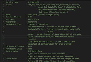

    here is the the prototype of the function:
    additionally the Spi_DataBufferType is defined as uint8 then both TX/RX buffers are defined as pointers to uint8 then if I didn't do this casting it will be implicitly done but by the way I have tried this this trial and it didn't impact anything.
