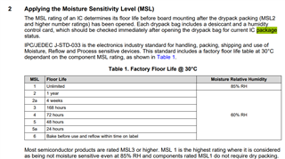

My customer has a question for AM625 package shelf time.
They are planning to reflow AM625 twice.
The package MSL rating is 3, so shelf time is limited to 1 week.
What does the 1 week limit exactly mean?
a) until the 1st reflow finishes
b) until the 2nd reflow finishes
c) or else
