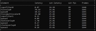

  • Here are the tracers for the gstreamer pipeline provided above which are close to 45 FPS:

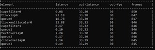

    Here are tracers from the gstreamer pipeline provided with the font size changed from 10 to 16 for both overlays:

  • Hi Steve,
    The multiscaler might be the bottleneck. Can you try two more things?
    1. add a "queue" element before tiovxmultiscaler
    2. keep tiovxmultiscaler and use fakesink
    Thank you.
    Jianzhong

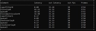

  • Here are some tracer results after applying the patches and using tiovxmultiscaler:
    1. Using fakesink
    2. Using kmssink instead of fakesink

  • Hi Steve,
    Using fakesink shows 45fps, which means the multiscaler patch helps.
    Can you share the pipeline of using kmssink?
    Jianzhong

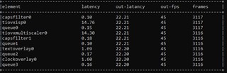

  • Hi Jianzhong,
    The display native resolution runs at 60 Hz. It seems to support a video stream at 45 Hz as best I can tell. Removing textoverlay and clockoverlay produced these tracers:
    Here was the pipeline I used:
    GST_DEBUG_FILE=/run/trace.log GST_DEBUG_NO_COLOR=1 GST_DEBUG="GST_TRACER:7" GST_TRACERS="latency(flags=element)" gst-launch-1.0 v4l2src io-mode=dmabuf-import device=/dev/video3 ! video/x-bayer, width=2600, height=1952, format=grbg10, framerate=45/1 ! tiovxisp sink_0::device=/dev/v4l-subdev2 sensor-name=SENSOR_ONSEMI_AR0521 dcc-isp-file=/opt/imaging/ar0521/linear/dcc_viss_GRBG_10b_2600x1952.bin sink_0::dcc-2a-file=/opt/imaging/ar0521/linear/dcc_2a_GRBG_10b_2600x1952.bin format-msb=9 sink_0::pool-size=8 src_0::pool-size=8 ! queue ! tiovxmultiscaler target=0 ! video/x-raw, format=NV12, width=1600, height=900 ! queue ! kmssink driver-name=tidss sync=false skip-vsync=true

  • Hi Steve,
    Ok. So this is similar to your original question:
    It seemed like adding "clockoverlay" and "textoverlay" gstreamer plugins to my pipe would do the trick but it is dropping my framerate from ~15 to  ~3 FPS.
    Now, with "clockoverlay" and "textoverlay", the fps dropped from 45 to 30.
    I think these are generic Gstreamer questions. You'll probably need to implement some kind of accelerated Gstreamer plugin for those overlays. A quick search found me something like this: https://shop.ridgerun.com/products/gstreamer-fast-text-graphics-overlay-1?variant=16668448751687.
