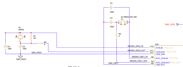

I create a board with AM335x and I used SDK tools to modify u-Boot and Kernel with my hardware. U-boot starts me up correctly and try to initialize the Kernel.
The problem is when Kernel try to start, I have a lot of errors with Clock and Timer and system stop starting.

For hardware, I used the same elements and connections as a AM335x-EVM and I connect SYSBOOT[15:14 ] = 01b = 24MHz.
I reviewed all files about EVM say to copy for creating my board (https://software-dl.ti.com/processor-sdk-linux/esd/AM335X/09_03_05_02/exports/docs/linux/How_to_Guides/Board_Port/U-Boot.html#integrating-support-for-a-new-board-into-the-u-boot-tree)  and I only found the following items regarding the clock and timer.

    Today I continued testing and finally I found that the problem is because the DTB is not compatible with my hardware. That is, I modified the following lines for my hardware.
    model = "TI AM335x EVM";
    compatible = "ti,am335x-evm", "ti,am33xx";
    I have verified that the DTB file I created for my hardware loads correctly but when I modify the compatible text, it stops loading the operating system.
    When the operating system starts, how does it know which hardware it is running on? How do I modify it so that it knows that it is my hardware and not the AM335x EVM?

  • Hi Xavier,
    some of the Kernel platform drivers like the clock driver or CPU frequency driver look for the compatible string on the board level and only then function properly...
    a0797059@jiji:~/git/linux (ti-linux-6.1.y)
    $ git grep '"ti,am33xx"' drivers/
    drivers/clk/ti/clkctrl.c:       if (of_machine_is_compatible("ti,am33xx"))
    drivers/clocksource/timer-ti-dm-systimer.c:     if (of_machine_is_compatible("ti,am33xx") ||
    drivers/cpufreq/cpufreq-dt-platdev.c:   { .compatible = "ti,am33xx", },
    drivers/cpufreq/ti-cpufreq.c:   { .compatible = "ti,am33xx", .data = &am3x_soc_data, },
    drivers/net/ethernet/ti/cpsw-common.c:  if (of_machine_is_compatible("ti,am33xx"))
    drivers/soc/ti/pm33xx.c:        if (!of_machine_is_compatible("ti,am33xx") &&
    So the right way for you to define your board-level compatible node would be to keep the platform-level compatible string in the `compatible` list, just like any of the other AM335x-based boards do, so that the drivers can get matched to your board.
    Something like this:
    compatible = "xavier-corporation,am335x-custom-board", "ti,am33xx";
