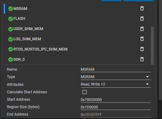

How to relocate heap region splitting between internal MSRAM and DDR4 ? Note that the maximum assignment of data in the MSRAM is about
0x1D0000 as shown here :

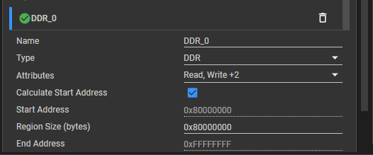

And the DDR4 regions is 2GB starting from : 0x80000000 and size = 0x80000000

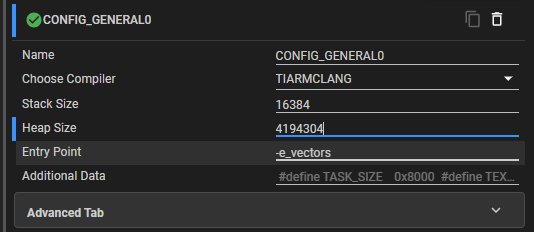

However; I need to malloc the heap of about 3MB in the application. But if assigning the heap to 4MB as shown here
then the build will generate error since the maximum allowed in MSRAM was 0x1D0000.

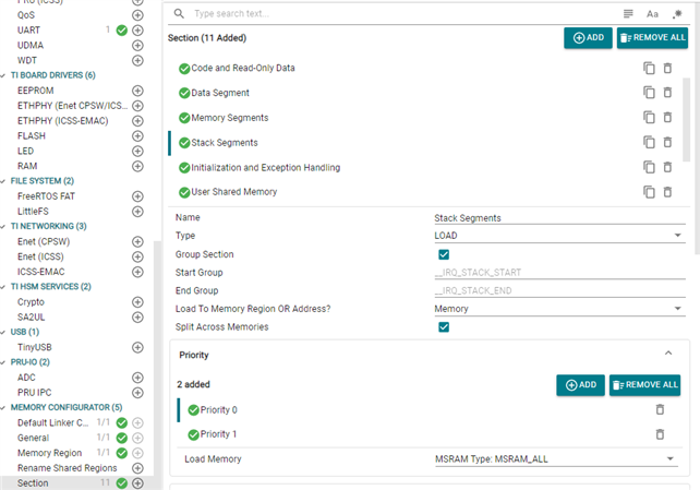

  • Hi Huynh,
    The question is how to change the SYSCONFIG to satisfy the heap of 3MB (allocating it to DDR4 memory) ?
    1. Select the option named Section in example.syscfg file.
    2. Go to the memory section you want to split.(Stack in this case).
    3. Enable the Split Across Memories option.
    4. Add the memory according to the priority or order.
    Please refer below image.
    Hope the above method helps.
