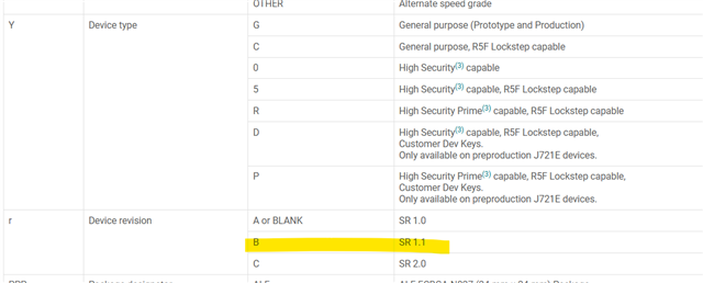

    Apologies, we are currently using the TDA4VM88T5BALFQ1 chip model, but I believe the principle is the same; it just requires changing sr1.1 to sr2.0. I have also conducted some tests, and I found that the baseline of SDK 8.6 can be programmed, but our current baseline is SDK 10.0. At present, I suspect two potential issues:
    1. Are there any modifications in the keywriter for these two baselines?
    2. It's possible that I made some mistakes during the keywriter compilation process.
    3. Can you provide documentation on keywriter compilation and related operational procedures?
      Br zhangbo
  • Hi Zhang,
    This is SR1.1 device
    now my understanding is you want to change this to SR2.0 sample and want to run keywriter on that, correct me if my understanding is wrong.
    With which silicon revision of device, you are testing with?
    You can follow the steps mentioned in this document , steps remain the same for newer sdk as well.
