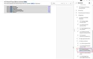

If you want to achieve the above method, then a well-known possible way is that the AM64X SOC should communicate with FPGA over the GPMC connection.
The GPMC is parallel communication and if you need full details please look at the chapter below.
I am not sure whether this connection is supported between the AM64X and FPGA.
If this connection is not supported, then what connection is there between SOC and FPGA? How are they communicating ?
