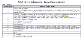

Part Number: AM62A7
What is VDDA_PLL5? I can only find it in the power sequencing

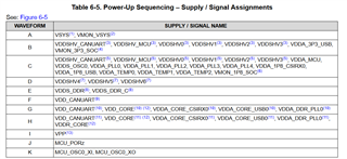

Hi Klaus,
VDDA_PLL5 is not there in the latest datasheet:
Could be a leftover from a similar device datasheet that was fixed in the latest version.
Download link: https://www.ti.com/product/AM62A7
