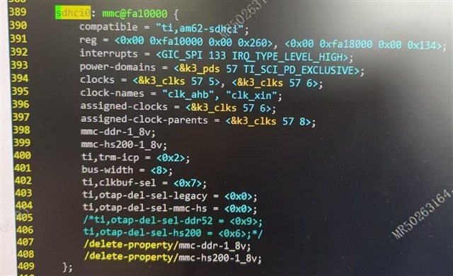

Linux SDK8.3, in order to limit eMMC to work at High speed 50MHz only. refer the patch for SDK8.6 to SDK8.3
https://e2e.ti.com/support/processors-group/processors/f/processors-forum/1221254/am623-custom-hardware---emmc-cqe-recovery-during-boot/
Patch for SDK8.6
Signed-off-by: Judith Mendez <jm@ti.com>
 arch/arm/dts/k3-am62-main.dtsi | 4 ++--
 1 file changed, 2 insertions(+), 2 deletions(-)
diff --git a/arch/arm/dts/k3-am62-main.dtsi b/arch/arm/dts/k3-am62-main.dtsi
index f3296f2671b..78ca7c34066 100644
--- a/arch/arm/dts/k3-am62-main.dtsi
+++ b/arch/arm/dts/k3-am62-main.dtsi
@@ -349,10 +349,10 @@
                ti,clkbuf-sel = <0x7>;
                ti,otap-del-sel-legacy = <0x0>;
                ti,otap-del-sel-mmc-hs = <0x0>;
-               ti,otap-del-sel-ddr52 = <0x5>;
-               ti,otap-del-sel-hs200 = <0x5>;
                ti,itap-del-sel-legacy = <0xa>;
                ti,itap-del-sel-mmc-hs = <0x1>;
+               /delete-property/mmc-ddr-1_8v;
+               /delete-property/mmc-hs200-1_8v;
        sdhci1: mmc@fa00000 {
2.17.1
modification in SDK8.3 of customer.

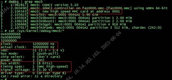

Result:
#1. eMMC works at 50MHz eMMC_CLK.
#2.  cat /sys/kernel/debug/mmc0/* shows signal voltage is 3.3V. but actually is 1.8V on custom board.

  • #1. Is the modification right to limit eMMC to High Speed SDR? In SDK8.6 dtsi there are option of itap, should add it to SDK8.3 also?
    The changes are correct to initialize the eMMC in HS mode.
    #2. The signal voltage supply fix to 1.8V in hardware, what is mean of 3.3V of cat /sys/kernel/debug/mmc0/* output?
    It cannot be the case. The eMMC initialization starts with 3.3V and later switched to 1.8V for the higher modes like HS200.

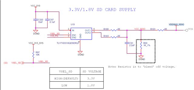

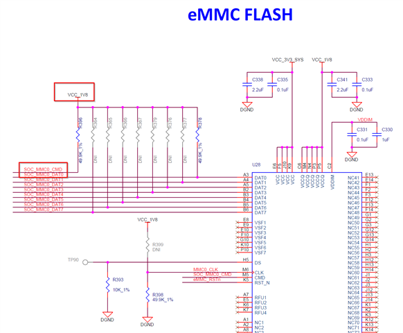

  • #1. Customer followed SK-AM62B board schematic, eMMC_CMD and DAT0 are external pulled up to 1.8V also. I think it can't be switched dynamically.
    #2. On SK-AM62B schematic, MMC1 connected SD card is the case, it has a dedicated power supply to switch between 3.3V/1.8V.

    delete mmc-ddr-1_8v;, mmc-hs200-1_8v from dts:
    root@am62xx-evm:~# dmesg |grep mmc0
    [    2.002399] mmc0: CQHCI version 5.10
    [    2.048162] mmc0: SDHCI controller on fa10000.mmc [fa10000.mmc] using ADMA 64-bit
    [    2.135543] mmc0: Command Queue Engine enabled
    [    2.140055] mmc0: new high speed MMC card at address 0001
    [    2.146665] mmcblk0: mmc0:0001 G1M15L 29.6 GiB
    [    2.156581] mmcblk0boot0: mmc0:0001 G1M15L 31.5 MiB
    [    2.162875] mmcblk0boot1: mmc0:0001 G1M15L 31.5 MiB
    [    2.170510] mmcblk0rpmb: mmc0:0001 G1M15L 4.00 MiB, chardev (239:0)
    root@am62xx-evm:~# cat /sys/kernel/debug/mmc0/*
    0x4000004b
    0x00860000
    52000000
    0
    # Command Timeout Occurred:      0
    # Command CRC Errors Occurred:   0
    # Data Timeout Occurred:         0
    # Data CRC Errors Occurred:      0
    # Auto-Cmd Error Occurred:       0
    # ADMA Error Occurred:   0
    # Tuning Error Occurred:         0
    # CMDQ RED Errors:       0
    # CMDQ GCE Errors:       0
    # CMDQ ICCE Errors:      0
    # Request Timedout:      0
    # CMDQ Request Timedout:         0
    # ICE Config Errors:     0
    # Controller Timedout errors:    0
    # Unexpected IRQ errors:         0
    clock:          52000000 Hz
    actual clock:   50000000 Hz
    vdd:            21 (3.3 ~ 3.4 V)
    bus mode:       2 (push-pull)
    chip select:    0 (don't care)
    power mode:     2 (on)
    bus width:      3 (8 bits)
    timing spec:    1 (mmc high-speed)
    signal voltage: 0 (3.30 V)
    driver type:    0 (driver type B)
    cat: '/sys/kernel/debug/mmc0/mmc0:0001': Is a directory
    root@am62xx-evm:~#
