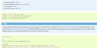

  • Hi Yaohui,
    To build a DFU-capable U-Boot to use as a programming tool you would typically use the SDK to build that, there's no need to use Yocto for this (but you can, if needed-- just more steps/work). Did you review the two documentation links I posted earlier? They should have all the instructions in there that are needed.
    The only noteworthy thing in there is that for building U-Boot SPL for R5 (a.k.a. "tiboot3.bin") for DFU you need to specify both am62x_evm_r5_defconfig and am62x_r5_usbdfu.config when configuring U-Boot, in the same command, like this.
    cd $UBOOT_DIR
    # R5
    # To build tiboot3.bin. Saved in $UBOOT_DIR/out/r5
    $ make ARCH=arm CROSS_COMPILE="$CROSS_COMPILE_32" am62x_evm_r5_defconfig am62x_r5_usbdfu.config O=$UBOOT_DIR/out/r5
    $ make ARCH=arm CROSS_COMPILE="$CROSS_COMPILE_32" O=$UBOOT_DIR/out/r5 BINMAN_INDIRS=$TI_LINUX_FW_DIR
    <...continue as per https://software-dl.ti.com/processor-sdk-linux/esd/AM62X/10_01_10_04/exports/docs/linux/Foundational_Components/U-Boot/UG-General-Info.html#build-u-boot ...>
    U-Boot is located at `<SDK_INSTALL_DIR>/board-support/u-boot-extras-jailhouse-2024.04+git/` for that particular AM62x SDK v10.01.10.04 you are wanting to use.
    Regards, Andreas
  • 你好,安德烈亞斯,
        我不太明白如何填寫以下內容
    $ export UBOOT_DIR=<path-to-ti-u-boot>
    $ export TI_LINUX_FW_DIR=<path-to-ti-linux-firmware> $ export TFA_DIR=<path-to-arm-trustede-firmware>
    $op export TFA_DIR=<path-to-arm-trute-firmware> $opp-f-ware> $op-Tg-to-arm-trude-firmware> $opp-f-ware
    > $op-Tp-to-arm
    Assuming I don't use SDK, I want to use Yocto environment to build DFU compilation tool. Is there any relevant process description?
    Please help again ~ ~ Thank you ~ ~
