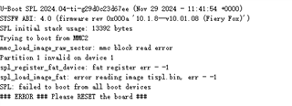

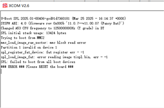

Serial console output:
U-Boot SPL 2025.01-00406-gcd91d7360181 (Mar 25 2025 - 16:14:37 +0000)
SYSFW ABI: 4.0 (firmware rev 0x000b '11.0.7--v11.00.07 (Fancy Rat)')
Changed A53 CPU frequency to 1250000000Hz (T grade) in DT
SPL initial stack usage: 13424 bytes
Trying to boot from MMC2
mmc_load_image_raw_sector: mmc block read error
Partition 1 invalid on device 1
spl_register_fat_device: fat register err - -1
spl_load_image_fat: error reading image tispl.bin, err - -1
SPL: failed to boot from all boot devices
### ERROR ### Please RESET the board ###
What are the potential causes of this problem, and what troubleshooting steps are required to fix it?
thank!

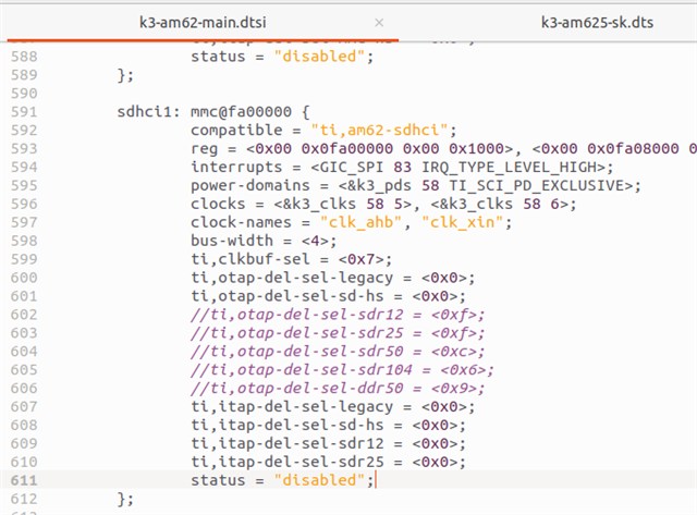

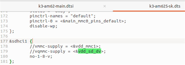

    #1. Changed dts in this folder (@ubuntu22:~/ti-processor-sdk-linux-am62xx-evm-11.01.05.03/board-support/ti-u-boot-2025.01+git/dts/upstream/src/arm64/ti$
    )  as below as custom board has only 3.3V for SD card.

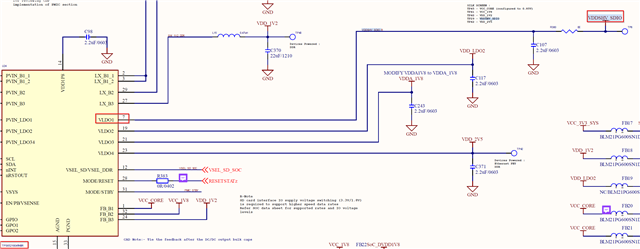

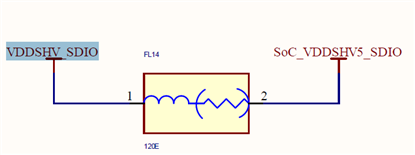

    #2. Custom board SD card power supply schematic as below, it is almost same as Beagleplay board design.

    Also, is custom board's schematics already reviewed?
  • I agree the high bootmode pin should not cause the issue, so I set to same on SK-AM62 board and booted with the same SD card.
    The schematic reviewed by Sreenivasa, no obviously error, just recommend to replace some pull up resistor value from 4.7K to 10Kohm.

    Is 50MHz MMC_CLK too high for custom board? can limit to lower frequency for test?
  • Is 50MHz MMC_CLK too high for custom board? can limit to lower frequency for test?
    That could be tried once with the legacy mode. Just comment out the OTAP property for SD HS mode.
  • Yes, can boot to UBoot by commenting out hs OTAP
    	sdhci1: mmc@fa00000 {
    		compatible = "ti,am62-sdhci";
    		reg = <0x00 0x0fa00000 0x00 0x1000>, <0x00 0x0fa08000 0x00 0x400>;
    		interrupts = <GIC_SPI 83 IRQ_TYPE_LEVEL_HIGH>;
    		power-domains = <&k3_pds 58 TI_SCI_PD_EXCLUSIVE>;
    		clocks = <&k3_clks 58 5>, <&k3_clks 58 6>;
    		clock-names = "clk_ahb", "clk_xin";
    		bus-width = <4>;
    		ti,clkbuf-sel = <0x7>;
    		ti,otap-del-sel-legacy = <0x0>;
    		//ti,otap-del-sel-sd-hs = <0x0>;
    		//ti,otap-del-sel-sdr12 = <0xf>;
    		//ti,otap-del-sel-sdr25 = <0xf>;
    		//ti,otap-del-sel-sdr50 = <0xc>;
    		//ti,otap-del-sel-sdr104 = <0x6>;
    		//ti,otap-del-sel-ddr50 = <0x9>;
    		ti,itap-del-sel-legacy = <0x0>;
    		ti,itap-del-sel-sd-hs = <0x0>;
    		ti,itap-del-sel-sdr12 = <0x0>;
    		ti,itap-del-sel-sdr25 = <0x0>;
    		status = "disabled";
