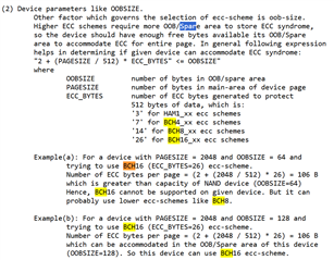

Our customer run into boot issue with NAND flash. We suspect it is caused by on-die ECC disabled when sysboot[9] is set to high. Could you please share the ROM source code with us for customer reference? Thanks
