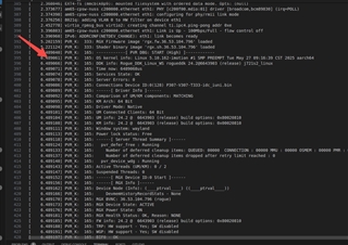

Our customer using TDA4VE is observing high “IO Wait” on the system. After checking the dmesg logs, they found that PVR log are printed at the same time when high IO Wait occurs.
Could you please help to check if there is a correlation between the high IO Wait and the PVR log? We are suspecting GPU operations are causing to IO Wait. Thank you

  • Another question is that after multiple tests, I found that this type of log sometimes appears and sometimes does not appear. Why is it a probabilistic event? Is there any problem with this?
    In general, these should be unrelated. I see this during boot-log, I suspect an issue with one of the offending peripherals. You may want to retry the boot by not loading the GPU module (either blacklist the module in your rootfs, or rename the kernel module name).
    What are you running in your file-system that is exercising GPU during the boot?
    In anycase, this may not be a GPU issue.

                  The printed log is in the pvr driver. If you don't load this ko file, there will definitely be no log.
