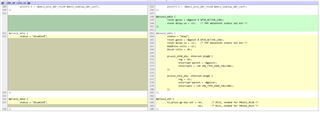

Hello again,
Using TI SDK 9.03 default image for the am57xx, I noticed that the pru ethernet does no show up when I run ifconfig or ip address.

  • Job,
    Can you share the DTS being used? perhaps the one you are using does not have the icss nodes it needs to setup the PRU ethernet.
    This patch should enable the all the ports on all IDKs.
    https://e2e.ti.com/cfs-file/__key/communityserver-discussions-components-files/791/0001_2D00_arm_2D00_dts_2D00_am57xx_2D00_idk_2D00_common_2D00_Relocate_2D00_MAC_2D00_Ethernet_2D00_Node.patch
    -Josue
  • Hello Josue,
    The SDK 9.03 default image uses the am574x-idk.dts from the ti-linux-6.1.y branch. I've cloned the repository and attached the file below. Additionally I tried applying the patch file you sent above and still experience the same problem.
    // SPDX-License-Identifier: GPL-2.0
     * Copyright (C) 2017 Texas Instruments Incorporated - https://www.ti.com/
    /dts-v1/;
    #include "am5748.dtsi"
    #include "dra7-mmc-iodelay.dtsi"
    #include "dra76x-mmc-iodelay.dtsi"
    #include "am572x-idk-common.dtsi"
    	model = "TI AM5748 IDK";
    	compatible = "ti,am5748-idk", "ti,am5748", "ti,dra762", "ti,dra7";
    &qspi {
    	spi-max-frequency = <96000000>;
    	flash@0 {
    &mmc1 {
    	pinctrl-names = "default", "hs";
    	pinctrl-0 = <&mmc1_pins_default_no_clk_pu>;
    	pinctrl-1 = <&mmc1_pins_hs>;
    &mmc2 {
    	pinctrl-names = "default", "hs", "ddr_3_3v";
    	pinctrl-0 = <&mmc2_pins_default>;
    	pinctrl-1 = <&mmc2_pins_default>;
    	pinctrl-2 = <&mmc2_pins_default>;
    &emif1 {
    	status = "okay";
    &pruss1_mdio {
    	status = "disabled";
    &pruss2_mdio {
    Thank you,
    -Job
  • Josue,
    I tried applying the patch and setting the status to "okay" but I am still getting the "Device not found" error from my first post. I also tried completely removing the two pruss_mdio configurations from the am574x-idk.dts and still got the same error.
    -Job
