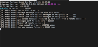

Hi Ti Team
I am trying to run the IPC RP Message Linux Echo demo application to test the RPmsg and LPM feature on AM62x-SK-Lp board.
I am following the steps mentioned in this link
https://dev.ti.com/tirex/explore/content/mcu_plus_sdk_am62x_11_00_00_16/docs/api_guide_am62x/EXAMPLES_DRIVERS_IPC_RPMESSAGE_LINUX_ECHO.html
Steps followed:
1.loaded the R5F image during tispl.bin
2. let the linux up and running
3. Enter these command and I can see some logs on Linux terminal
But as mentioned in the link, I don't see the expected output on the WakeUp UART. Also, nothing happens when I type on the UART terminal.
Did I miss something and make a mistake?
Mayank
  • Hello Mayank,
    Your output for RPMsg looks the way I would expect. I am sending your thread over to our low power owner for comment. Feel free to ping the thread if you have not received another response within a day or so.
    Nick

  • HI Anshu, kindly look into the response and suggest what should be the next steps to run this application
  • Hi Mayank,
    Can you provide details of your setup so I can replicate it on my end?
    What all is plugged into the SK-AM62-LP board?
    What software changes have been made on the Linux side and M4F IPC firmware?
    As Nick mentioned, low power modes are not supported if the DM R5F core is used for general purpose applications. Additionally, low power modes are only supported using SPL boot.
    Anshu
  • Hi Anshu
    Yes, we're using SPL Boot flow and integrating ipc_rpmsg_echo_linux.wkup-r5f0_0.strip.out from the example in tispl.bin for R5 as suggested in this link
    https://dev.ti.com/tirex/explore/node?node=A__AZNhqJdyJ3LM.YBw-Z2UAw__AM62-ACADEMY__uiYMDcq__LATEST
    There is no firmware on the M4F side, and we're using the TI U-Boot from the TI-processor-sdk-linux-am62xx-evm-11.00.09.04 to load the default Linux.
    That's our setup.
    Mayank
  • Hi Mayank,
    There is a bug in the PMIC driver for AM62x on SDK 11.0 which impacts SK-AM62-LP: https://sir.ext.ti.com/jira/browse/EXT_EP-12340
    Can you try on SDK 10.1? This bug is planned to be fixed in SDK 11.1.
    Anshu
