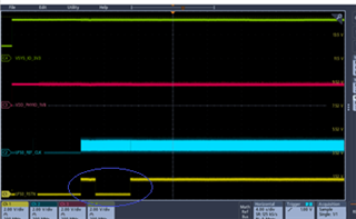

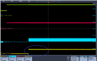

We face UFS reboot failed because of UFS0_RSTN do not active low.
Success Boot, UFS0_RSTN active low
Failed Boot, UFS0_RSTN do not active low

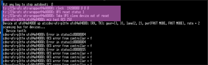

So we try to find toot cause and debugging
I think it should be control by UFS u-boot driver, isn't? (ti-j721e-ufs.c)
How to make sure we already trigger "UFS0_RSTN pin" ?
Which register control this pin in TRM?
