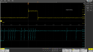

Hi.
We have a AM6422 with one 16b DDR4.
Attached measurement shows, that termination after write is switched off too early., resulting in ringing on DQS pair (green signal, differential measured) The total assertion time is correct (10 CLK in this case) but it also seems to get activated a little bit too early.
we set up write preamble to 1CLK, but it looks more like 1.5CLK...
How this can improved?
regards,
Christian

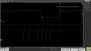

    Meanwhile I searched for other options to optimize ODT timing and found an interesting bit:
     CTLPHY_WRAP__CTL_CFG__CTLCFG_DDR16SS_DENALI_CTL_373 Register (0F30 85D4h):
    EN_ODT_ASSERT_EXCEPT_RD
    Enable controller to assert ODT at all times except during reads.
    Assumes single ODT pin connected. Set to 1 to enable.
    I tested this and got the attached results (original settings and changed ODT assertion mode). So, this seems to solve the issue that ODT is switched off to early during write. On the other hand, we now have to check if ODT is disabled fast enough during read.
    Do you have any concern to use this functionality?

    I was looking back at your original scope shot.  How can you tell the termination is enabled early?  It appears from that shot that it only is getting disabled too early.  What is the orange signal? If it is ODT, it seems inverted, but i don't understand why if floats to mid supply
    Also just curious if you are seeing any functional failures?

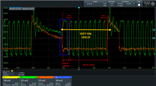

    The orange line in the original scope plot is a data line. On this line, you can see when termination is getting active. The termination seems to be active for 10CLK, as it should be. But since this strange preamble (~1.5CLK) it seems that it is switched off to early (while the total termination ON time is fine).
    I think the root cause of this problem is the timing of the preamble
    regards,
    Christian

    All right. No, we don´t see functional errors, but EMI is not very good. We think this overshoot could be the root cause.
    regards, Christian
  • Hi Christian, sorry for the delay here.
    I checked the register dump, and it looks like all training steps are passing.
    I also showed some of your scope shots to a colleague.  He did mention that the 1.5tCK width of the Write preamble meets JEDEC spec min of 0.9tCK, and the width is similar to what we have seen in validation.  Also, we did see some ringing at the end of the burst (see below)
    and was able to suppress it by enabling Rtt Park
    Note that we did not validate operation with Rtt park enabled, since it was functional with it disabled.  However, you may see if you want to experiment with this to see if it affects your EMI.
    There isn't an option to change RttPARK from the Register Configuration Tool.  However, you can modify the configuration file manually.  MR5 value that the DDR4 controller uses is in these registers:
    CTL_236, PI_302
    You will see similar values in other register, but those don't need to be changed and are irrelevant for the controller in DDR4 mode.
    James
