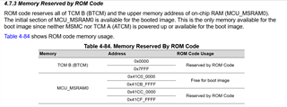

I have some questions related to the memory usage of the UBOOT R5 SPL and the UBOOT A72 SPL.
When I build the U-Boot R5 SPL and I check the corresponding map file, I find the start address 0x0000000080800000. According to the technical Reference Manual this would be the DDR memory range is that correct?
If yes, could you tell me which code part is initializing the DDR before the UBOOT R5 SPL is running?

  • Hi Jonas,
    R5 SPL does not run out of DDR. It is the bootloader component that initializes the DDR.
    The R5 SPL itself is loaded and executed from the MCU SRAM. Following is the memory layout used by the initial MCU R5F bootloader components.
    This is typically the address that A72 SPL is loaded at and ATF uses to jump to.  Please note that the U-Boot bootloader binaries are typically position independent executables (PIEs), so it depends on where you link them against.
    Correct.
