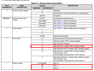

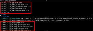

    If we need to boot an HS-FS device (either 5B or 5C silicon) using the Linux SDK, is the following understanding correct:
    We can use all GP images except for the following two, which must be replaced:
    Small blue diamond For 5B HS-FS :
    1. Replace sysfw-j721e-gp-evm.itb
      ➜ with sysfw-j721e_sr1_1-hs-fs-evm.itb
    2. Replace tiboot3-j721e-gp-evm.bin
      ➜ with tiboot3-j721e-sr1_1-hs-fs-evm.bin
    All other images (such as tispl.bin, u-boot.img, kernel, DTB, rootfs, etc.) can remain as GP versions.
    Small blue diamond For 5C HS-FS :
    1. Replace sysfw-j721e_gp-evm.itb
      ➜ with sysfw-j721e_sr2_0-hs-fs-evm.itb
      ➜ with tiboot3-j721e-sr2_0-hs-fs-evm.bin
    Again, all other images can remain as GP versions.

  • Remark For Jay
    What's mean for 5B/5C,
  • Hi Jay,
    Are you trying this with the TI TDA4VM EVM or a customer board?
    Yes, the tiboot3.bin files will change though if this is for a Customer board. They would have to add support in U-Boot for their board, and the signing will be dictated by their binman.
    As I stated earlier, TI SDKs use signed images even for other binaries on HS-FS (single build config between HS-FS and HS-SE). The GP version binaries for other images should work on HS-FS.
    Unless there is a strong motivation to use GP only unsigned binaries, I recommend to follow the same style as TI SDKs.

    • Now, we plan to replace the GP device with a 5C HS-FS device on the same board.
    • The goal is to boot the HS-FS device using the existing GP images (except sysfw and tiboot3) for early-stage functional testing.
    Motivation
    • At this stage, we have not yet programmed the device with Keywriter, so the device is still in HS-FS  state.
    • We hope to reuse the GP images to boot and verify key hardware interfaces .
    • Once functional verification is complete, we will proceed to program the device with Keywriter, effectively converting it to a  HS-FS state.
    • In the final stage, we will re-test using fully signed images as per the standard secure boot flow.
    Summary
    Our question is whether it is acceptable for early-stage HS-FS bring-up to temporarily use GP-signed images (except tiboot3 and sysfw).
    Appreciate your confirmation and guidance.
    BR
    JAY
  • Hi Jay,
    We’d like to further confirm our use case, which involves transitioning from GP to HS-FS device for early board bring-up and functional validation.
    Thanks for the background.
    What Linux SDK is your Customer using? U-Boot has evolved while enabling the boot-support for HS-FS and also to use YAML and BinMan for generating the sysfw.itb file.
    This will convert the device to HS-SE once KeyWriter is run.
    My recommendation would be to follow the same flow as what is being used as TI SDK, as this would be the standard recommended method.
    But I understand that you want to try this as part of your early-stage board bringup. I suggest that you open a new thread if you run into any issues, I do not have a HS-FS board to check/verify this myself.
    regards
    Suman
