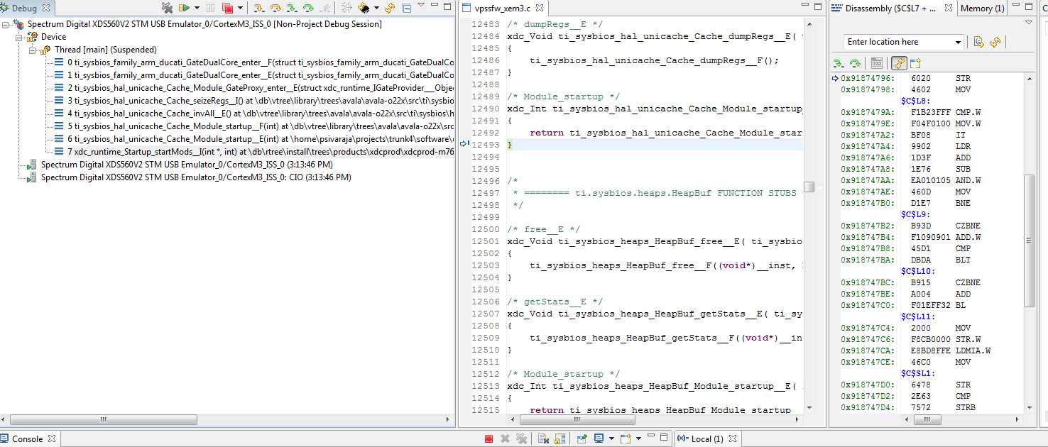

I in the process of enabling the unicache that is shared by the video and display M3s on DM8168. Once I enable cache I am unable to load code as my code hangs in the enable cache routine before it hits main. So I am not sure whether I am missing step in enabling a cache or whether I am doing something else wrong.

When I load this code using CCS, it hangs before it even hits main(). See screen shot of where its hanging. Not sure what's going on here.

  • From the screen shot can you tell why the code is hanging?

  • I did more experimenting. I did NOT turn cache on in my .cfg file but still left the Cache_inv routines in my code. This time I was able to load my code and step through it but got stuck at the same place as pictured above when I tried to execute cache_inv(). So I knew I was missing something that the cache routines needed. After more digging(thanks to another post on e2e) I found out that it was because the gates protecting access to the unicache registers shared by the two M3s need to be initialized. So as per the post I found, I added the following to my .cfg file.
    var GateDualCore = xdc.useModule('ti.sysbios.family.arm.ducati.GateDualCore');
    GateDualCore.initGates = true;
    This seems to solve the gates not being initialized issue. Now with cache turned OFF the cache_inv() routines do NOT get stuck and everything works fine.

  • 1) When the unicache is enabled, there has to be an AMMU table entry for every ducati CPU access below address 0xe0000000. Otherwise you'll get a page fault exception.
    2) The GateDualCore module will get configured automatically if you set the Core.id of your respective ducati core applications accordingly:
        var Core = xdc.useModule('ti.sysbios.family.arm.ducati.Core');
        Core.id = 0;   /* for the application running on Core 0 */
    and
        Core.id = 1;   /* for the application running on Core 1 */

  • Thanks Alan....Adding AMMU table entries seems to do the trick and now I can run my application without any issues.
