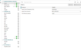

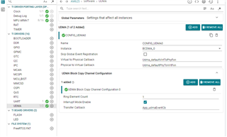

Q1) When UDMA is enabled in sysconfig, it seems TIMER7 is automatically enabled as "Other dependencies".
Is this mandatory for UDMA? TIMER7 cannot be used for other purpose?
    In MCU+SDK 11.0, there is no direct link or dependency between Timer 7 and UDMA.
    I have reviewed the current SDK and confirm that:
    • UDMA is not tied to any specific timer
    • Timer 1 appears in the default SysConfig-generated configuration, but it is primarily used by the FreeRTOS scheduler
    • This timer is not used or required for UDMA operations
    Please refer to the attached image .
