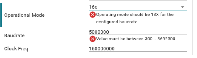

I want to set the UART baud rate of USART1 to 5 Mbaud. According to table 12-470 in TRM this should be possible by using a clock source of 160MHz, a divider of 1 and the baud multiple set to x16. I am using SysConfig (1.14.0+2667) to configure the processor. With the mentioned parameters I get an error:

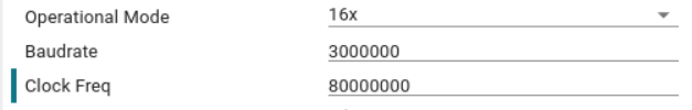

 I played around a bit and came up with the following setting:

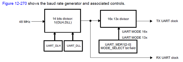

With these parameters I see uart communication (measured with oscilloscope) with 5Mbaud. That's fine, but from the documentation I can not understand why these values result in a baud rate of 5M. Somehow it feels not right. I found these drawings in the TRM:
Can you give me some more insights how calculations are done? Thanks in advance.

  • Yes exactly. I took a shot of the RX (and TX) signal(s). The duration of a bit is 200ns. The uart is connected to an FPGA. Communication between Sitara and FPGA works fine @5MHz.
  • So, the thing is that you set a frequency of 80 MHz and a baud rate of 3 MHz, but baud rate came out to be 5 MHz. This is strange behaviour.

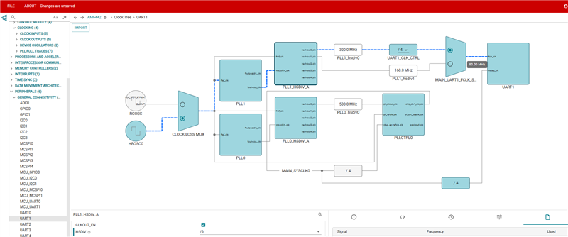

    By looking at the clock tree tool for AM64x, I see that a frequency of 80 MHz is possible with the following combination as shown in the diagram below.
    I am assuming the clock is setup correctly for your flow.

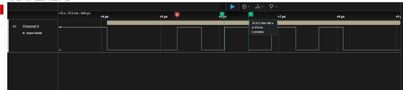

    I have connected the logic analyzer to the UART2 TXD and seen the waveform as following:
    If you read closely, it sends the following string: "This is uart echo test blocking mode\r\nReceives 8 characters then echo's back. Please input.."
    I am going to measure the baudrate now and check if it is by default 115200 and then post this I will give your configurations and check if mismatch in baud rate is seen or not.
    Thanks for your patience.
    Vaibhav
    Just a quick UPDATE:
    For the sample application where 115200 is configured, I see the baud rate of 115,207.37 on the waveform which is okay.

    Please tell me what will be the baud rate based on the diagram below?
    I have made some changes which reflect the settings of 16x, baud rate: 3000000 and frequency: 80 MHz. From the above diagram please let me know what will be the baud rate, if you need further pointers do let me know as well.
