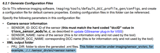

  • Hi Sajan,
    I am trying to get 4k resolution video output from using IMX219 cam connected to am62a via arducam v3 link adapter board.
    Have you been able to get 1080p video from the existing DCC bin files?
    Below is the terminal print of generate_dcc.sh shell script (seems some errors).
    The segmentation fault is probably caused by wrong path for "PRJ_DIR" in the config file.This folder must be under imaging/sensor_srv/src, for example, ../../../sensor_drv/src/imx219_output. Please refer to the AM6xA ISP Tuning Guide:
    I checked if it works through running a simple gstreamer pipeline. Seems some error associated with memory allocation.
    Please regenerate the bin files after fixing the seg fault. You'll also need to configure all elements in the media device topology to be 4k resolution. Please refer to this FAQ: What are the common reasons V4L2 based applications fail to capture images from a probed CSI sensor?
    Jianzhong
    I successfully generated the bin file without any errors.

    Now I only changed the SENSOR_WIDTH, SENSOR_HEIGHT to 3840 and 2160 respectively. Is it fine. I mean the camera is perfectly working in 1080.
    Will try to achieve it !
