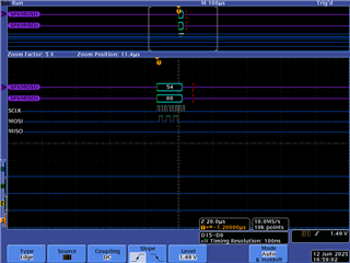

I've moved on to a full J721E board with the SOM from a TVA4VM board, now accessing MCSPI3 and MCSPI6 through the GESI board. I'm using MCU2_1, FreeRTOS, using the 10.x TI SDK w/ PDK.
I've observed I can successfully transmit and receive on each, but in every case I've tried, I'm only transmitting one byte. I would expect there to be the entire message.

I've discovered if I enable TURBO mode, I get two bytes, but I never get the whole message. Also if I change 'dataSize' in the SPI_Params struct, it does seem to scale to two bytes, but it's impractical for larger messages.

    I currently have SPI3 directly connected to the oscilloscope. Nothing is being done to SPI6 at the moment.
    The only reason I'm including SPI6 here is to show that this isn't only happening to SPI3. I'd likely be able to demonstrate this with other SPIs if I can access them easily. In either case, I'm only using one SPI, whether it be 3 or 6, connected to the oscilloscope.

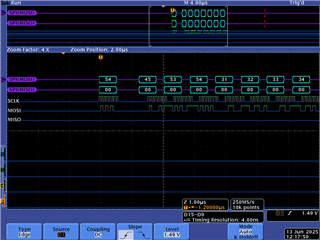

    Edit2: I changed the bitrate to be 12 MHz. I'm seeing the full message, and it seems it's hinting at what is happening:
    A large gap is between the first byte and the rest. No idea what is delaying it, but at lower bit rates, that gap is where it gets cut off. And yes, at the lower bit rate, the rest of the message is definitely not transmitted. I've verified this by eliminating the `Osal_delay(10);` and seeing that it's just repeating the one byte over and over.
    Do understand that a higher bit rate is not the solution here.
  • So disabling the FIFO (.enableFIFO = 0) in the SPI_HWAttrs seems to allow the full expected data through, so the problem seems to be FIFO related. The question now is how come?

    Yes, everything seems to work fine if in callback mode, but not in blocking.

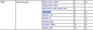

  • So I dug deeper into how the chip select works after noticing that I was not getting chip select out at all. It actually does seem the case that the chip selects are aligned with the channels (CS0 for channel 0, CS1 for channel 1, etc.) When I started using channel 1 for everything, chip select comes out and so does the entire 8 bytes of the message!
    Can you still keep blocking mode and try with TxRx mode ?
    Tried this, and whether it's TX only or TX-and-RX mode has no effect.
    So what I think is going on is that CS0 is not pinmuxed out for the GESI board. Either I would have to go in and pinmux it for our case and rebuild the board library, or use a different chip select. Because it wasn't pinmuxed out, it was using that ball for something else, and when the SPI code tried toggling the chip select, it'd have a "stutter" of some kind, cutting off the message or delaying the rest of the message.
  • Hello Tyler,
    As you mentioned TI EVM +GESI board is being used, I checked in GESI schematics .
    If there is any reconfiguration of this PIN to any other usage then misbehavior can be expected.
    Not every pin can be probed out in the TI boards . If you are able to use SPI3_CS1 ,please continue to use it. It is the same functionality as CS0.
    Yes there could be an chance where SPI3_CS0 related ball has been configured for some other pin and that can be in use.
    That's good to hear and this confirms there is no issue with PDK driver.
