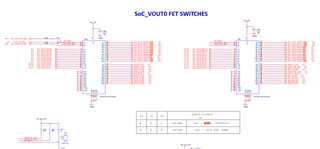

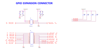

I'm trying to test SPI comunication on AM62L EVM but I'm having trouble getting it to work. I've read similar threads and tried those solutions with no luck. I hope you can help me to check if there is anything wrong or missing in my procedure. I'm using the default kernel as starting point.
What I've done so far and some of my outputs:
1. Modified kernel configuration with menuconfig
Device Drivers --->
[*] SPI support
<*> User mode SPI device driver support
2. Modified device tree (k3-am62l3-evm.dts), using sysconfig tool output. I also changed all to INPUTS according to a suggestion on other thread, but none of the configurations worked.
spi1_pins_default: spi1-default-pins {
pinctrl-single,pins = <
AM62LX_IOPAD(0x008c, PIN_INPUT, 4) /* (H22) GPMC0_AD5.SPI1_CLK */
AM62LX_IOPAD(0x0080, PIN_INPUT, 4) /* (K22) GPMC0_AD2.SPI1_D0 */
AM62LX_IOPAD(0x0084, PIN_INPUT, 4) /* (J23) GPMC0_AD3.SPI1_D1 */
AM62LX_IOPAD(0x0088, PIN_INPUT, 4) /* (K23) GPMC0_AD4.SPI1_CS0 */
&main_spi1 {
#address-cells = <1>;
#size-cells = <0>;
status = "okay";
pinctrl-names = "default";
pinctrl-0 = <&spi1_pins_default>;
spidev@0 {
spi-max-frequency = <24000000>;
reg = <0>;
compatible = "rohm,dh2228fv";
Also, here is the full device tree file: k3-am62l3-evm.dts (modifications: removed conflicting pin drivers -dss and gpmc- and added spi1 node)

Oscilloscope probes are on CLK and CS0 (header pins 30 and 27) and D0 - D1 (pins 28 and 29) are connected together with a jumper to test loopback communication. I don't see any activity on any line. I've already double checked my probes and jumpers.
