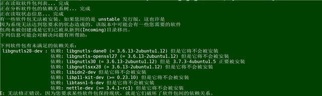

/home/cesar/sdb/j722s/ti-processor-sdk-linux-adas-j722s-evm-11_00_00_08/board-support/ti-u-boot-2025.01+git/tools/mkeficapsule.c:20:10: fatal error: gnutls/gnutls.h: 没有那个文件或目录
   20 | #include <gnutls/gnutls.h>
compilation terminated.
