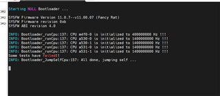

I am working on the SK-AM-62-LP board and trying to boot the R5F code with a simple custom application. We're not using CCS studio to generate binary.
Instead, we have our own CMakeLists.txt, toolchain.cmake, and linker.cmd and .syscfg that we use for driver sources generation using sysconfig tool.

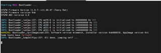

The binary which is generated when I flash through SBL prebuilt file is failing as shown in the below screenshot.
To me, it looks like r5f is not getting initialized for some reason but I am not able to understand/debug this scenario.
We have tried to make our makefile as close as possible to the makefile in CCS project and used all necessary tools available in mcu_plus_sdk_am62x_11_00_00_16 for it.
Let me know if you require any more information on this. We can share the files if required

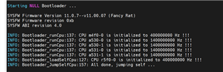

  • Hi Mayank,
    As you are using SBL NULL, I assume you are not booting any application on DM R5, could you confirm if you are loading some application on DM R5 via CCS, if not then it is expected that you will not have any logs from DM R5 as it is not running any application.
    You are getting the boot logs from SBL NULL as expected: software-dl.ti.com/.../EVM_SETUP_PAGE.html

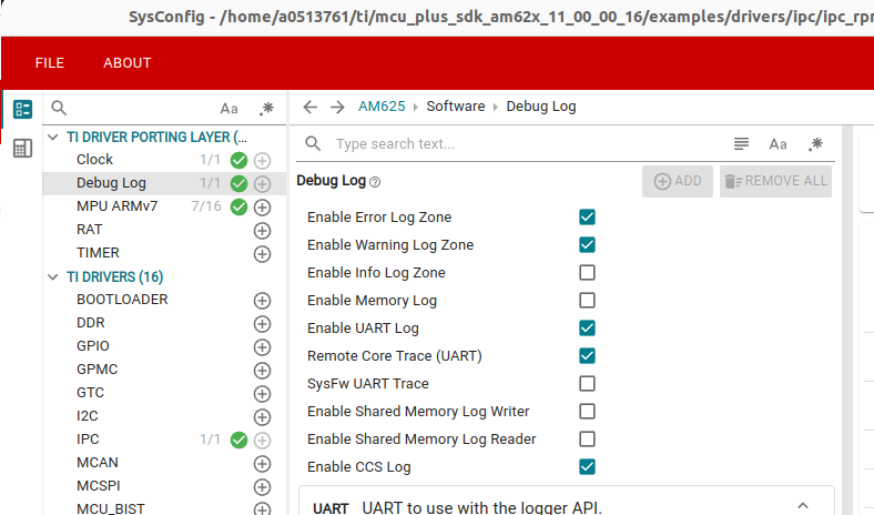

  • Can you share your syscfg file? You need to enable the UART log for your application from syscfg.
    Is it possible to share your makefile as well? Is it exactly same as the makefile in the SDK?
  • Since this and open forum. We can provide the file over mail. Will that be okay ?
  • Could you just make sure that this Enable UART is checked in the syscfg:
  • Yes, that is checked. We've directly used the syscfg file from a TI example

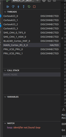

  • Are you calling loop_forever at the start of your DM application? If yes then it is possible it is stuck there. If this is also not the issue then you can try to debug the application and try to see where you are facing the issue, this guide can help you with the same: https://software-dl.ti.com/mcu-plus-sdk/esd/AM62X/10_01_00_33/exports/docs/api_guide_am62x/DEVELOP_AND_DEBUG_DMR5.html#autotoc_md308

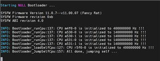

  • The issue we're facing is that the image generated by our custom project isn't running as expected.
    The main UART is displaying the correct output (I'll attach the logs), but there's no output on the DM/R5 UART.

  • Hi Meet
    I have tried debugging the R5 core. I don't see the control going to the main. All I see is a location address in the Call Stack when I halt the program.
    Also, it's a custom project, so I am unsure how successful I was in debugging it correctly. Attaching the screenshot. Let us know if I performed it correctly
    1. I started the debugging session
    2. Connected the R5 Target
    3. Loaded the symbol
    4. Put the breakpoint in main.
    5. Continue the debugging. R5 core shows running, but the control does not reach the main
    6. I halt the program where I see an address(See in the call stack in screenshot attached)
    It'd be appreciated if you could look into the image generation from the CMake file that Lukasz has provided. That could give us a hint if the image generation is done properly.

  • Hi Mayank,
    There seems to be some problem with your vip_r5f_stripped.appimage.hs_fs image, could you try once with vip_r5f.appimage.hs_fs image.
  • HI Meet,
    Flashed  vip_r5f.appimage.hs_fs as well,
    C:\ti\mcu_plus_sdk_am62x_11_00_00_16\tools\boot>
    C:\ti\mcu_plus_sdk_am62x_11_00_00_16\tools\boot>python uart_uniflash.py -p COM21 --cfg=sbl_prebuilt/am62x-sk-lp/default_sbl_null_hs_fs.cfg
    Parsing config file ...
    Parsing config file ... SUCCESS. Found 4 command(s) !!!
    Executing command 1 of 4 ...
    Found flash writer ... sending sbl_prebuilt/am62x-sk-lp/sbl_uart_uniflash_stage1.release.hs_fs.tiimage
    Sent flashwriter sbl_prebuilt/am62x-sk-lp/sbl_uart_uniflash_stage1.release.hs_fs.tiimage of size 265901 bytes in 25.6s.
    Executing command 2 of 4 ...
    Command arguments : --file=../../examples/drivers/boot/sbl_uart_uniflash_multistage/sbl_uart_uniflash_stage2/am62x-sk-lp/r5fss0-0_nortos/ti-arm-clang/sbl_uart_uniflash_stage2.release.appimage.hs_fs --operation=flash --flash-offset=0x0
    Sending ../../examples/drivers/boot/sbl_uart_uniflash_multistage/sbl_uart_uniflash_stage2/am62x-sk-lp/r5fss0-0_nortos/ti-arm-clang/sbl_uart_uniflash_stage2.release.appimageSending ../../examples/drivers/boot/sbl_uart_uniflash_multistage/sbl_uart_uniflash_stage2/am62x-sk-lp/r5fss0-0_nortos/ti-arm-clang/sbl_uart_uniflash_stage2.release.appimageSending ../../examples/drivers/boot/sbl_uart_uniflash_multistage/sbl_uart_uniflash_stage2/am62x-sk-lp/r5fss0-0_nortos/ti-arm-clang/sbl_uart_uniflash_stage2.release.appimageSending ../../examples/drivers/boot/sbl_uart_uniflash_multistage/sbl_uart_uniflash_stage2/am62x-sk-lp/r5fss0-0_nortos/ti-arm-clang/sbl_uart_uniflash_stage2.release.appimageSending ../../examples/drivers/boot/sbl_uart_uniflash_multistage/sbl_uart_uniflash_stage2/am62x-sk-lp/r5fss0-0_nortos/ti-arm-clang/sbl_uart_uniflash_stage2.release.appimageSending ../../examples/drivers/boot/sbl_uart_uniflash_multistage/sbl_uart_uniflash_stage2/am62x-sk-lp/r5fss0-0_nortos/ti-arm-clang/sbl_uart_uniflash_stage2.release.appimageSending ../../examples/drivers/boot/sbl_uart_uniflash_multistage/sbl_uart_uniflash_stage2/am62x-sk-lp/r5fss0-0_nortos/ti-arm-clang/sbl_uart_uniflash_stage2.release.appimage                                                                                                                                                                            Sent ../../examples/drivers/boot/sbl_uart_uniflash_multistage/sbl_uart_uniflash_stage2/am62x-sk-lp/r5fss0-0_nortos/ti-arm-clang/sbl_uart_uniflash_stage2.release.appimage.hs_fs of size 141748 bytes in 16.7s.
    [STATUS] SUCCESS !!!
    Executing command 3 of 4 ...
    Command arguments : --file=sbl_prebuilt/am62x-sk-lp/sbl_null.release.hs_fs.tiimage --operation=flash --flash-offset=0x0
    Sent sbl_prebuilt/am62x-sk-lp/sbl_null.release.hs_fs.tiimage of size 291629 bytes in 30.27s.
    Executing command 4 of 4 ...
    Command arguments : --file=C:/Users/kj1mdj/Downloads/vip_r5f.appimage.hs_fs --operation=flash --flash-offset=0xA00000
    Sent C:/Users/kj1mdj/Downloads/vip_r5f.appimage.hs_fs of size 182055 bytes in 19.95s.
    All commands from config file are executed !!!
    The result is the same, no output on wakeup UART

    Please connect to the WKUP R5F core and share the address at which it is suspended at. Please do not load anything. After booting, if you don't observe logs on the WKUP UART port then only connect to the core and share the address.
  • Hi Prashant,
    If I connect the target, I seethe  address as shown in attachment below
  • Hi Mayank,
    The issue is with the core ID that is being passed with your TI_APPIMAGE_GEN_PATH command. Please set TI_APPIMAGE_GEN_CORE_ID to "4" instead of "0x04"
    Meet.
  • Hi Meet
    Changing TI_APPIMAGE_GEN_CORE_ID to "4" breaks something, and we don't see the CPU R5f initialization. Kindly see the screenshot
    Mayank
  • Hi Mayank,
    This is due to wrong software version set in the makefile. TI_ELF2RPRC_JS_SW_VERSION. is set to 1.0, it should be set to 0xb000010, to match the installer software version.
  • Hi Meet,
    Changes CoreID to 4, Sw version to 0xb000010. Also added the boot_armv7r files.
    Now it is behaving the same as earlier. Initialization is passed, but NO output onthe  wakeup UART

  • Hi Mayank,
    I am now able to at least boot the binary shared by you, so it seems that the issue with the booting is resolved. I could see while debugging that it is getting stuck inside xTaskCreateStatic API, as I don't have access to all your files I can't comment further on what could be the issue. I would recommend you debugging the R5 application now using the guide I shared before: https://software-dl.ti.com/mcu-plus-sdk/esd/AM62X/11_00_00_16/exports/docs/api_guide_am62x/DEVELOP_AND_DEBUG_DMR5.html#autotoc_md325
    Meet.
  • Hi Meet
    I do see control reaching the main now while debugging.
