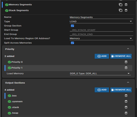

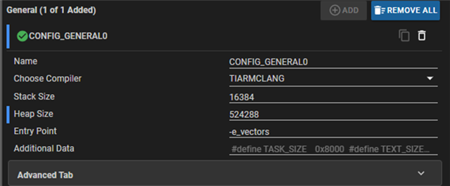

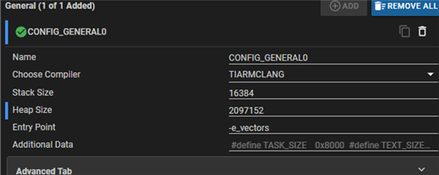

The issue was when need the HEAP memory needed beyond the capacity of MSRAM(2MB). So
In the Memory Configuration Section, under General I increase the heap size as :
And under Section, Memory Segments, I  split across memories with DDR as :
My application is to read the user’s data in the flash region starting 0x100000 and ending at 0x280000 with the app to be programmed at 0x80000 as per “default_sbl_ospi.cfg” file. In my application I will load this user’s data into the pointer variable (in the heap memory).

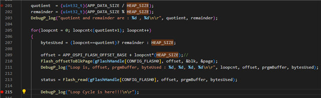

    status = Flash_read(gFlashHandle[CONFIG_FLASH0], offset, prgmBuffer, byteUsed);
    Each time this line is executed, please give me the value of offset. prgmBuffer and byteUsed in every loop.
    Please send me your default_sbl_ospi.cfg file as well.
    Vaibhav
  • The second loop is stuck at Flash_read() and never get to break point.
    #define APP_DATA_SIZE               (1241804U)
    #define HEAP_SIZE                         (262144U)
    uint8_t *prgmBuffer __attribute__((aligned(32U))) = (uint8_t *)malloc(HEAP_SIZE);
    Here is the CIO information :
    quotient and remainder are : 4 , 193228
    Loop is, offset, prgmBuffer, byteUsed : 0, 1048576, 1879874224, 262144
    Loop Cycle is here!!!
    Loop is, offset, prgmBuffer, byteUsed : 1, 1310720, 1879874224, 262144

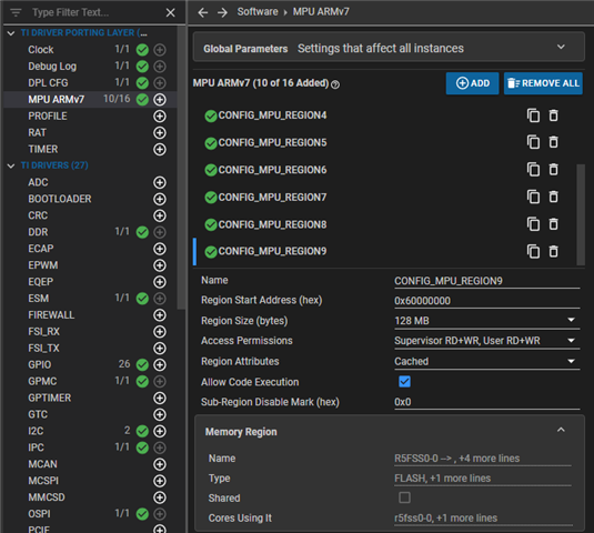

    Can you check if the MPU ARMV7 configurations contain the region starting from 0x60000000?
    If not defined its okay, if defined then can you tell me if the region 0x60000000 is cached or not?
    Vaibhav
  • Interesting that I change Region Attributes from Cached to Non-cached or Strongly Ordered then the loop is working now. Could you explain to difference
    between Non-Cached and Strongly Ordered ?
    I am pretty glad this came out.
    I had a suspicion around the region from 0x60000000 being cached as I have mentioned here in the previous response:
    So the region for OSPI should not be cached, the reason being the data in the region can be stale and hence, we have to avoid using cached. One follow up question from you could be cached can increase the data read speed, well for that front, we go the other route, where we increase the frequency, use Phy mode and use DMA mode in combination to achieve higher read speeds.
