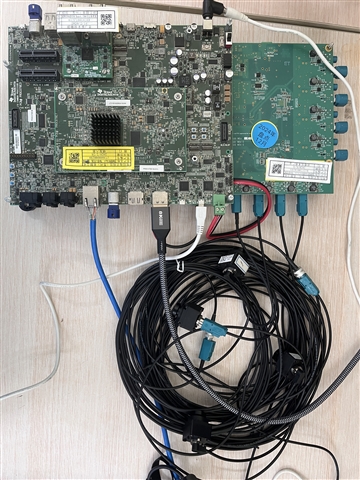

I am currently facing an issue with insufficient bandwidth on the 960. Here are the details:
Currently, I am probably using a single CSI-2 output port to transmit 4 video streams. How can I configure it to use 2 CSI-2 output ports to transmit 2 video streams respectively? Maybe this can solve my current problem. Thanks!

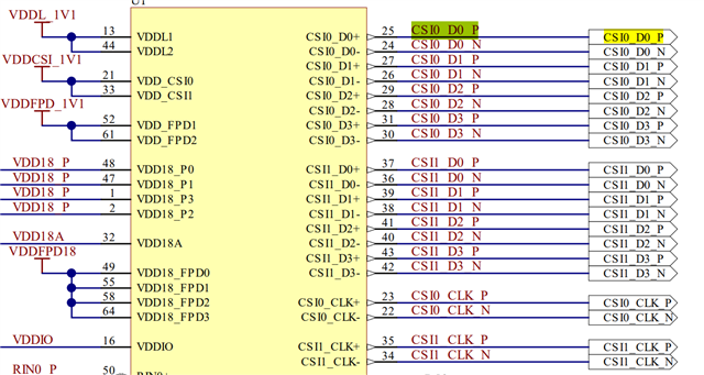

  • Hi Ying Li,
    You can use both CSI-2 TX ports to transmit 2 video streams each, as following:
    After you configure all other registers that you want to configure, and configure the SER + Image sensor, write:
    Write to DES reg 0x20 = 0xFC ## Route RX port0 and 1 to CSI-2 Tx port0, and route RX port2 and 3 to CSI-2 Tx port1
    Write to DES reg 0x20 = 0x0C ## Enable Forwarding of all Rx ports to Tx.

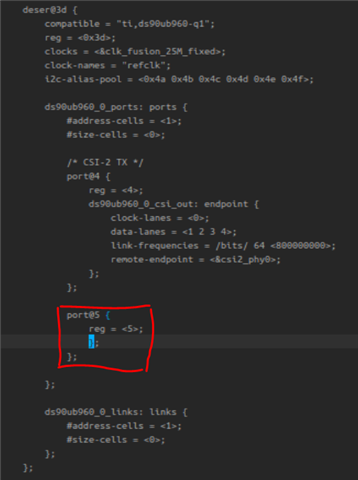

    Thank you very much for your help. After the 0x20 register is configured successfully, only CSI-2 Tx port 0 can output two video streams, while port 1 fails to output.
    1. I configured it in the 960 driver code before starting the video stream.
    2. Do I need to modify the device tree? I added port5, but I'm not sure how to fill in the information inside port5. I tried to refer to port4, but all tests failed.
    I hope I can get your help. Thank you!
  • Hello Ying Li,
    Have you enabled the second CSI-2 Tx port? You should do that in register 0x33 as following:
    Write DES reg 0x32 to 0x13 ## enable I2C write to CSI-2 Tx ports 0 and 1
    write DES reg 0x33[0] to 1 ## enable the CSI-2 Tx ports 0 and 1
    and then
    1. I have followed the steps you mentioned. But it failed to solve the problem. Here are the register values read when my video stream starts and stops.The registers seem to be fine.
    2. Does the device tree really not need to be modified?
    Thanks!

    I am using the development board shown in the image below. Thank you very much!
