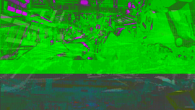

Can one DEI be connectted to two Hvenc?
Other Parts Discussed in Thread: TVP7002
SDK:EZSDk5.03.0.9
HW:Dm8168
I connect two Hvenc component to one DEI component,then two h.264 file was produced,but the content of the h.264 file is error, look like random images.

  • I use the following OTMB oms file:
    omx setp 0 vfcc numoutbuf 6
    omx setp 0 vfcc frame_width 1920
    omx setp 0 vfcc frame_height 1080
    omx setp 0 vfcc op_chromat_format 420SP
    omx setp 0 vfcc outbufalign 0
    omx setp 0 vfcc outbuf_contig disable
    omx setp 0 vfcc outbufsize 3110400
    omx setp 0 vfcc data_opmode driver
    omx setp 0 vfcc outbuf allocate
    omx setp 0 vfcc outbufsize_flag disable
    omx setp 0 dei frame_width 1920
    omx setp 0 dei frame_height 1080
    omx setp 0 dei op_chromat_format 420SP
    omx setp 0 dei ip_chromat_format 420SP
    omx setp 0 dei numinbuf 6
    omx setp 0 dei inbufalign 0
    omx setp 0 dei inbuf_contig disable
    omx setp 0 dei inbufsize_flag disable
    omx setp 0 dei inbufsize 3110400
    omx setp 0 dei numoutbuf 8
    omx setp 0 dei outbufalign 0
    omx setp 0 dei outbuf_contig disable
    omx setp 0 dei outbufsize_flag enable
    omx setp 0 dei outbufsize 4147200
    omx setp 0 dei data_opmode driver
    omx setp 0 dei inbuf use
    omx setp 0 dei outbuf allocate
    omx setp 0 h264venc numinbuf 8
    omx setp 0 h264venc frame_width 1920
    omx setp 0 h264venc frame_height 1080
    omx setp 0 h264venc inbufsize 4147200
    omx setp 0 h264venc numoutbuf 4
    omx setp 0 h264venc outbufsize_flag enable
    omx setp 0 h264venc outbufsize 3110400
    omx setp 0 h264venc data_ipmode driver
    #To enable write to SD card change mode to file
    #omx setp 0 h264venc data_opmode file
    omx setp 0 h264venc outfile /usr/share/ti/data/videos/dm816x_1080p60_encode.264

    omx setp 0 dei OMX_TI_IndexParamVFPCNumChPerHandle nNumChannelsPerHandle 1
    omx api setparam dei 0 0 0 OMX_TI_IndexParamVFPCNumChPerHandle
    omx setp 0 dei OMX_TI_IndexConfigAlgEnable bAlgBypass enable
    omx setp 0 dei OMX_TI_IndexConfigAlgEnable nChId 0
    omx api setconfig dei 0 0 0 OMX_TI_IndexConfigAlgEnable
    omx setp 0 dei OMX_TI_IndexConfigSubSamplingFactor nSubSamplingFactor 1
    omx api setconfig dei 0 0 0 OMX_TI_IndexConfigSubSamplingFactor
    omx setp 0 dei OMX_TI_IndexConfigVidChResolution Frm0Width  1920
    omx setp 0 dei OMX_TI_IndexConfigVidChResolution Frm0Height 1080
    omx setp 0 dei OMX_TI_IndexConfigVidChResolution Frm0Pitch  1920
    omx setp 0 dei OMX_TI_IndexConfigVidChResolution Frm1Width  0
    omx setp 0 dei OMX_TI_IndexConfigVidChResolution Frm1Height 0
    omx setp 0 dei OMX_TI_IndexConfigVidChResolution Frm1Pitch  0
    omx setp 0 dei OMX_TI_IndexConfigVidChResolution FrmStartX  0
    omx setp 0 dei OMX_TI_IndexConfigVidChResolution FrmStartY  0
    omx setp 0 dei OMX_TI_IndexConfigVidChResolution FrmCropWidth 1920
    omx setp 0 dei OMX_TI_IndexConfigVidChResolution FrmCropHeight 1080
    omx setp 0 dei OMX_TI_IndexConfigVidChResolution eDir input
    omx setp 0 dei OMX_TI_IndexConfigVidChResolution nChId 0
    omx api setconfig dei 0 0 0  OMX_TI_IndexConfigVidChResolution
    omx setp 0 dei OMX_TI_IndexConfigVidChResolution Frm0Pitch  3840
    omx setp 0 dei OMX_TI_IndexConfigVidChResolution Frm1Width  1920
    omx setp 0 dei OMX_TI_IndexConfigVidChResolution Frm1Height 1080
    omx setp 0 dei OMX_TI_IndexConfigVidChResolution Frm1Pitch  1920
    omx setp 0 dei OMX_TI_IndexConfigVidChResolution eDir output
    #omx api setconfig dei 0 0 16  OMX_TI_IndexConfigVidChResolution
    omx setp 0 dei OMX_TI_IndexParamBuffMemType eBufMemoryType default
    omx api setparam  dei  0 0 0  OMX_TI_IndexParamBuffMemType
    omx api setparam  dei 0 0 16  OMX_TI_IndexParamBuffMemType
    omx api setparam  dei 0 0 17  OMX_TI_IndexParamBuffMemType
    omx setp 0 dei OMX_IndexParamCompBufferSupplier eBufferSupplier unspecified
    omx setp 0 dei OMX_IndexParamVideoInit nPorts 3
    omx setp 0 dei OMX_IndexParamVideoInit nStartPortNumber 0
    omx api getparam  dei 0 0 0 OMX_IndexParamPortDefinition
    omx setp 0 dei OMX_IndexParamPortDefinition video.nStride 1920
    omx api setparam  dei 0 0 0 OMX_IndexParamPortDefinition
    omx api getparam  h264venc 0 0 0 OMX_IndexParamPortDefinition
    omx setp 0 h264venc OMX_IndexParamPortDefinition video.nStride 1920
    omx api setparam  h264venc 0 0 0 OMX_IndexParamPortDefinition

    and h.264 file from the DEI output #1is normal,but h.264 file from the DEI output #0 is as such:
    what is the reason???
