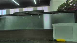

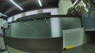

I am using the MATLAB script for correcting an LDC image.
Lens distortion correction looks good in the first place, but straight lines look wobbly.
How to improve this issue?

  • Hi Jianzhong
    Below is the script and settings I used
    s = 1.15;
    m = 4;
    pitch_in_mm = 0.0021;
    f_in_mm = 4;
    W = 3840;
    H = 2160;
    hc = W/2;
    vc = H/2;
    Wmesh = ceil(W / 2^m) * 2^m;
    Hmesh = ceil(H / 2^m) * 2^m;
    gen_lut("spec_file.txt", pitch_in_mm, f_in_mm, Wmesh, Hmesh, hc, vc, s, m);

  • Hi li,
    Your lens spec file does not look good.
    Both columns must have higher precision.
