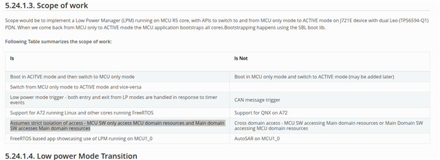

5.24.1. MCU Only mode — Platform Development Kit (PDK) - JACINTO User Guide
I referred to this demo and conducted some tests on mcu1_0. There are some issues that require your help.

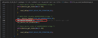

1.I called the Sciclient_service in mcu1_0 to reset the MAIN domain, expecting that mcu1_0 could continue to run. However, in reality, both the A core and mcu1_0 got stuck. Why was this so?
2.When I was migrating the PMIC from the ACTIVE state to the MCU only state, after writing to the FSM_NSLEEP_TRIGGERS register, I expected MCU1_0 to continue running. However, the phenomenon was that both MCU1_0 and A and got stuck. Please help analyze the reason.
3.The current startup mode we are using is SPL. To implement the MCU only mode and be able to switch back to the ACTIVE mode, can the startup mode of SPL be achieved? Are there any relevant reference materials?
I see that the startup mode used in the current demo is SBL, and when switching from mcu only mode to active mode, pulling up other core parts of the main domain again is missing
