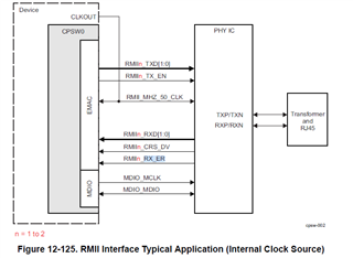

In our design, there is a network switch IC using RMII without RMII_RX_ER pin connected to AM623,  when we trying with ping action, AM6232 keeps reporting iet_rx_smd_err and can not establish communication with switch, does this related to the pin missing ? is there any way to dismiss this error or disable RX_ER pin?
