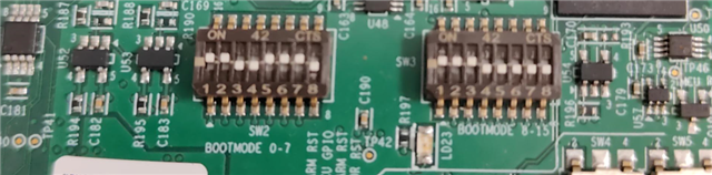

    And we selected the dip switch position as OSPI Boot Mode: SW2(11010000) SW3(01000000) on AM64x GP EVM, and we could able to load all images using the following cmds with tftp server connected with target board.

    Thanks for your feedback, We tried with xSPI mode( sw2 1100111101 and sw3 00000000) after you suggested and we are facing the same response similar to ospi mode,herewith attached logs with commands provided in sd card mode and changing to xspi mode, no response from DUT, Can you share the entire procedure for xSPI
    SankarLogs.log
  • We tried with xSPI mode( sw2 1100111101 and sw3 00000000)
    You have too many bits here, something isn't right.
    To make sure you are configuring for xSPI boot modes and to rule out any issues with switch settings (which can be confusing at times), try the following:

    This means your boot mode switches were not set correctly. Please set them to 0xe73, just like the command I gave you. You might need to dive a bit deeper into the schematic & board design data to exactly understand which switch controls which bit. The GP EVM User's Guide has that info too.
    Regards, Andreas

    Set boot settings as SW3(00001110)   SW3(01110011) (0xe73) as you mentioned.
    modified boot mode to xSPI with SDCARD presence we are able boot complete image.
    But if we remove SD card and try to boot complete image from OSPI it is coming up to U-BOOT and getting something attached the log data pls check and suggest us.
    Same team....

  • Set boot settings as SW3(00001110)   SW3(01110011) (0xe73) as you mentioned.
    Have you tried power-cycling the board after changing the boot mode? The bootmode pins are only read by the ROM code during the lowest level of reset, which is power-on reset, but also during MCU_PORZ reset (the latter which may or may not be accessible on the AM64x EVM board through a switch). So power-cycling is your best bet to make sure.
    If this still doesn't work, why don't you take a (macro) photo of your boot mode switches on your board and post it here for review.
    Regards, Andreas
    Still, it's not getting boot from xSPI mode.
