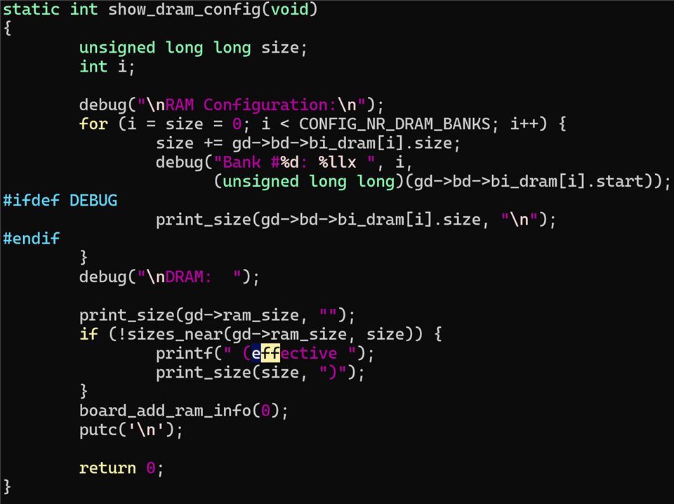

so if i keep the int dram_init_banksize(void) section and add #define CONFIG_SYS_SDRAM_BASE 0x80000000 in the evm.h , it compiles but my board doesn't boot i get only the below
U-Boot 2023.04-dirty (Jun 17 2025 - 19:32:19 +0530)
CPU  : DRA752-GP ES2.0
Model: FASBC5728
Board: FA SBC5728
DRAM:  2 GiB (effective 4GiB)
after this the board stops booting.
Could you help me boot the board with 4GIB emif configuration in SDK 9.03 uboot.
